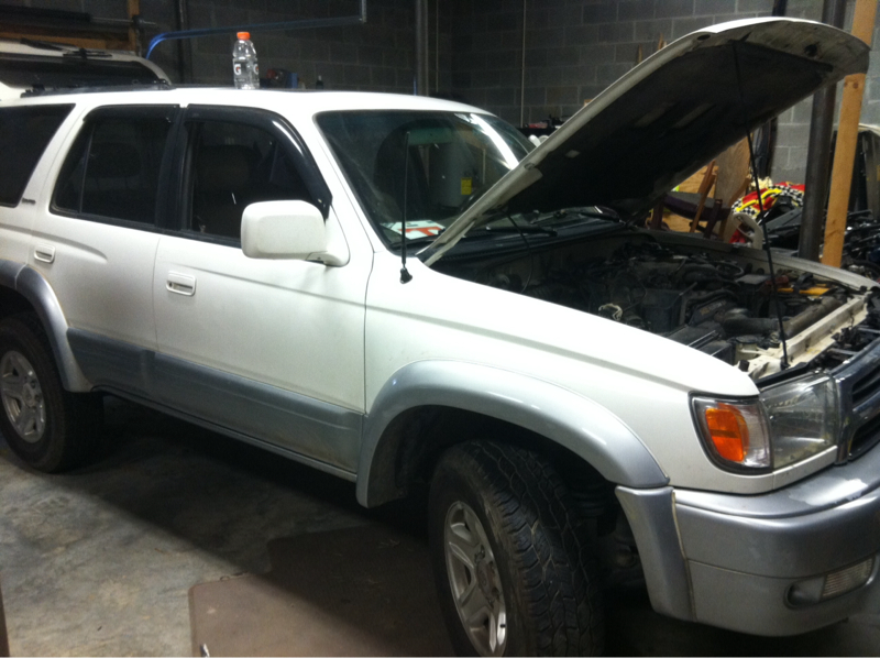

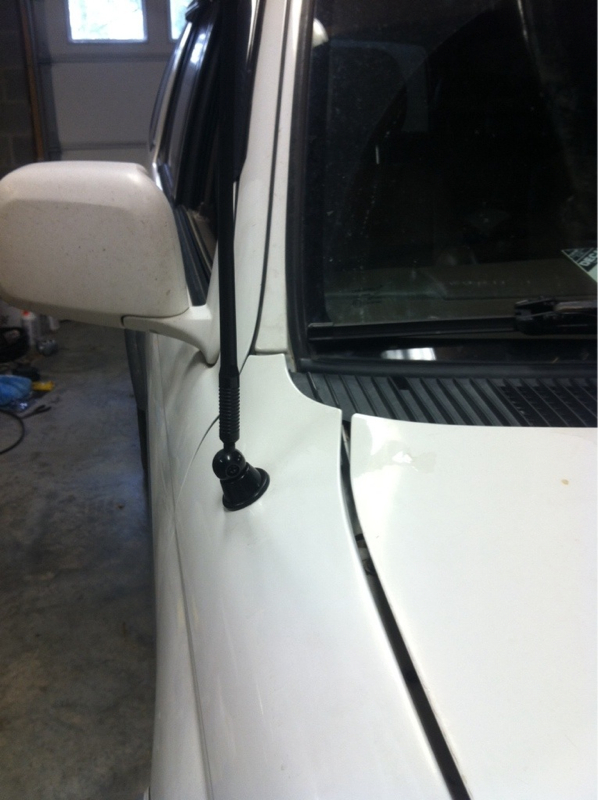

By the way, I recently replaced my broken motorized antenna (antenna part was gone) with a $13 universal one from O'Reilly Auto Parts.
