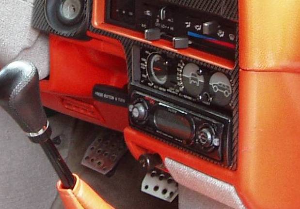

How bout somethin diffrent?

Nice job. It looks very cool and fits like the factory did it. I like the paint job, who did the details on your truck?
