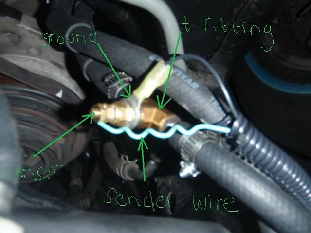

Mechanical or electrical gauges? I just finished installing my electrical tranny temp gauge, wiring should be the same with a water temp gauge except for the location of the sender. Make sure your grounds are good, This was happening to my gauge too until I moved the ground from the base of the sender to the t-fitting. See picture.
Goodluck!
