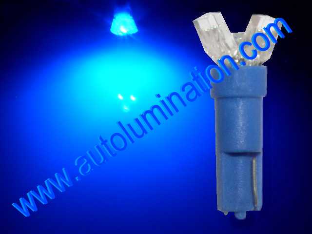

Originally Posted by Cooker30
Sorry to keep bringing up a VERY old thread but what type of #74 bulbs did you guys use. On superbrightleds.com they had a bunch of different types and i dont want to load up on a bunch if they aren't the correct sizing.
depends where your putting it, you need a short one for the key ring light but basically, your looking at ones that look like this
To all who do this, order 2-3 spares for each bulb you plan on replacing, I had to pull out my dash and take out all the blue ones because eventually, they kept flickering and then just stopped working for no reason. I'm not sure why. I had to go back to stock! So sad. Well now my HVAC and cig lighter and gear shift indicators are the only ones with cool lights in them.

Update: Well since almost all my new led bulbs burnt out except the one in my gear shifter and the key ring, i had to go back to stock bulbs, but recently I found a seller on ebay that sells the ones I wanted
He actually sent me the wrong ones which i posted below, but I msg'd him and he is sending the correct ones free of charge and I get to keep these weird ones that also worked but did not produce that hyper blue color that my old ones did
So for about $3.40 cdn and free shipping. It only took 2 weeks to arrive from China, and yes i know how sketchy ppl feel about ordering from them. once my new ones arrive, i will test them. and give u the ebay sellers name. great to deal with, i cant believe hes sending me the right ones without asking me to return the wrong ones.
If anyone knows where I can buy cheap tri-led's #74 bulbs for the HVAC, please post. preferably not vleds or autoilumination.
