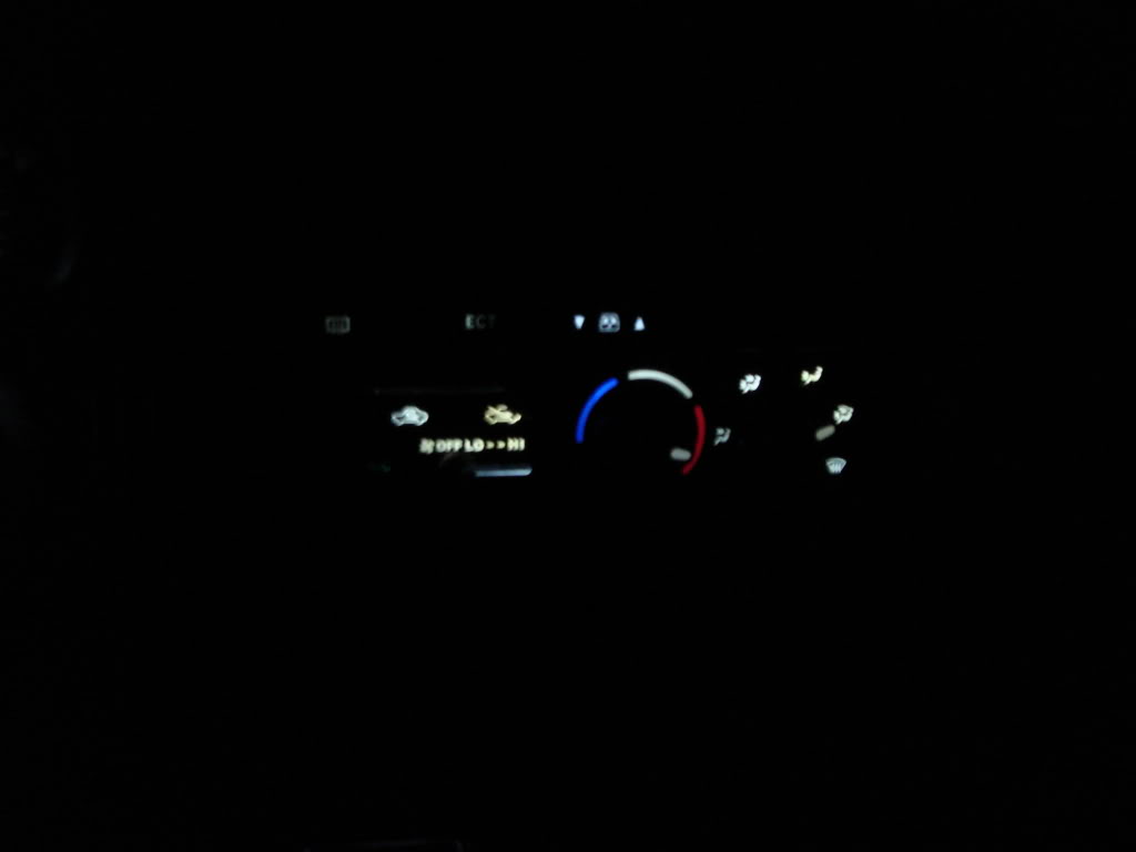

UPDATE: no more hotspots !
I installed the 3 smt HP leds in my hvac http://cgi.ebay.com/ebaymotors/ws/eB...K%3AMEWNX%3AIT
And man it looks looks great.
To avoid hotspots I put a realy good size dab of clear RTV silicone on the top bulb to dim and dispurse the light alittle(try not to get silicone on the side bulbs) . And spun the bulb socket so the other two side bulbs direct the light well
Heres a pic :

and heres a pic of before with the single HP led
