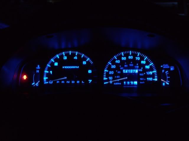

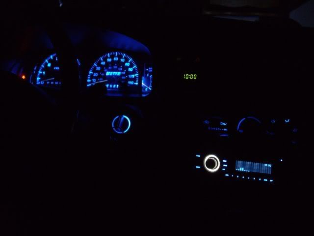

Alright, sorry the pictures took forever, my computer self-destructed on me. Here they are:

The LEDs are available in various colors... white, blue, red, purple, amber, etc...
I would definitely like to change my clock to blue, but I don't even know if that is possible? If not I may just unplug it since my deck has a clock on it.
