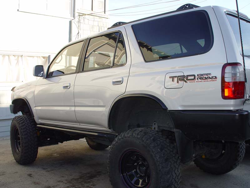

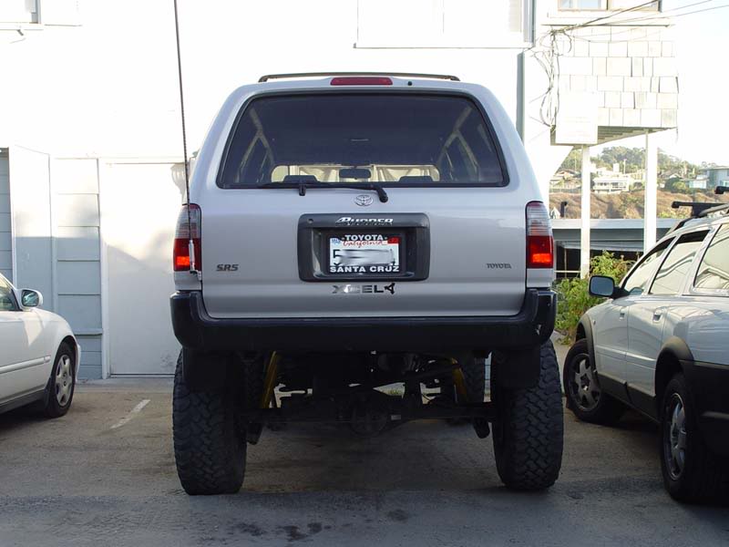

Here's a couple of pictures. I tried to measure but my pavement is really uneven...(My rear came out to be like 4 inches higher)
Need to get some good offroad pictures hah.
