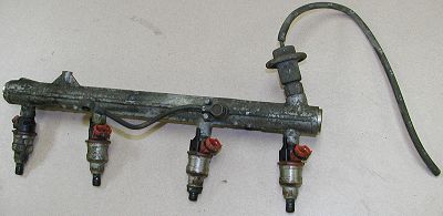

Are you talking about this pipe?
I don't remember anything having left-hand threads on this fuel rail.
