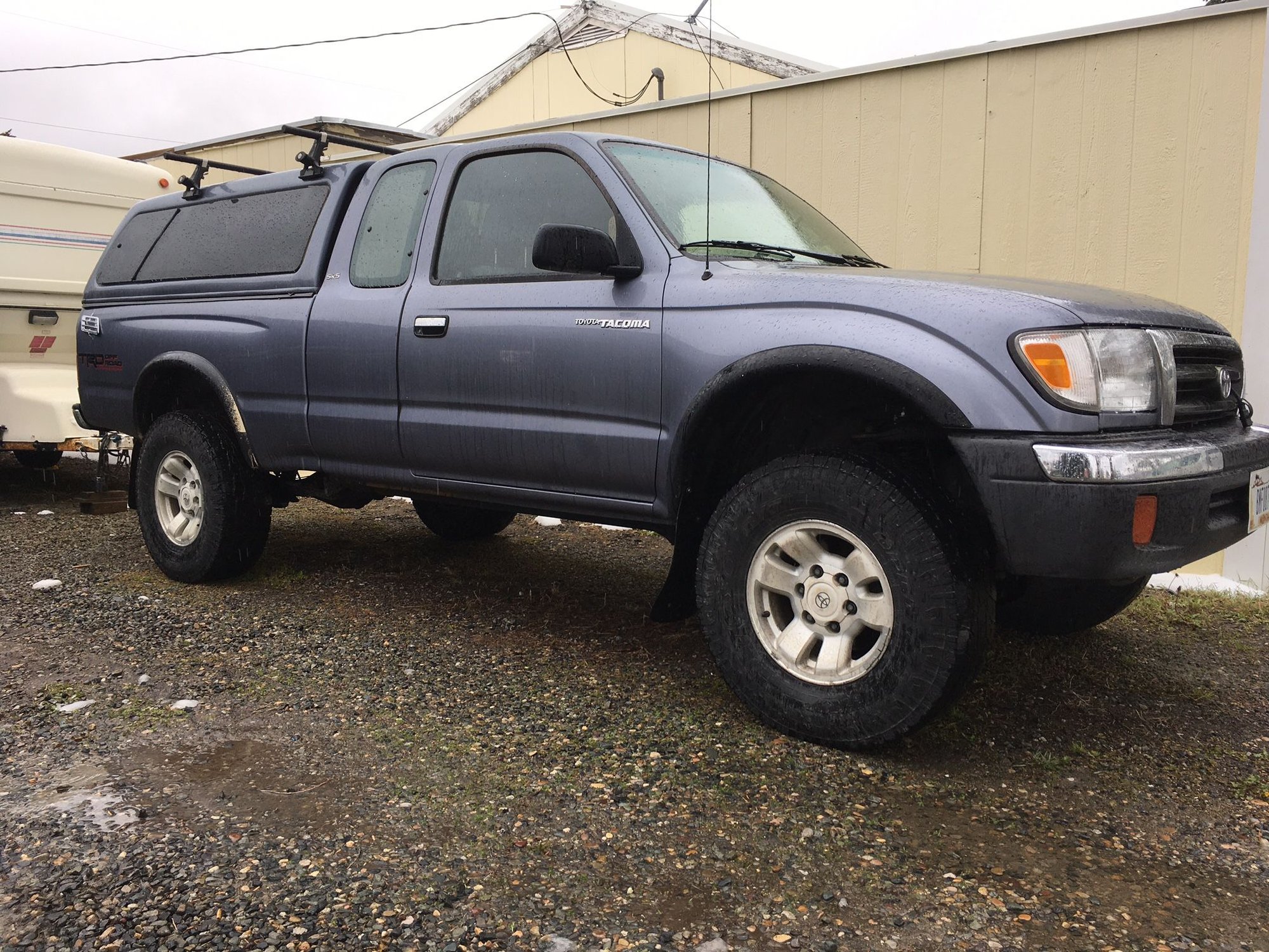

Shocks and coils are on. So far, they feel great. Not harsh, but they definitely take bumps. I got about an inch lift out of them, which will hopefully settle a little. Hard to compare without a before photo, but the front is definitely significantly higher than it was before. The front tire was all the way into the wheel well before.
