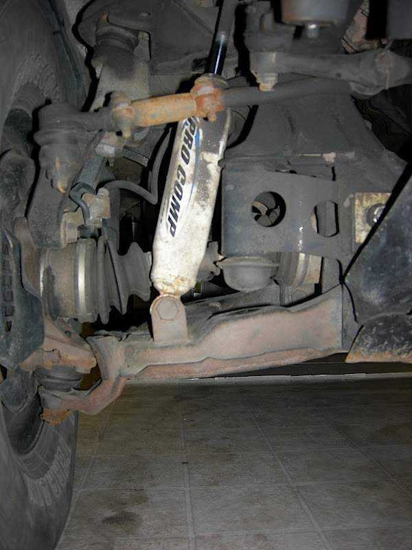

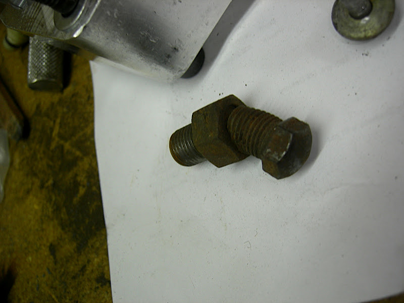

This is what a bent one looks like:
I don't have a better pic than this, but the bolt above hits the half-moon piece to the right of the lower balljoint:
