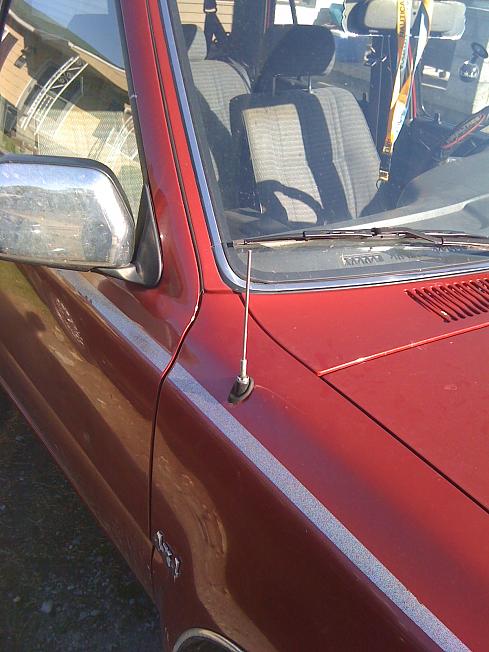

i just cut mine way down lol.
Attached Thumbnails Fixed antenna for 4R - searched and now confused?-img_0386.jpg
