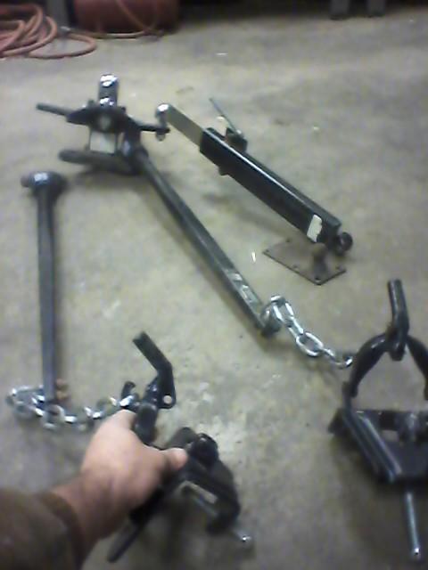

The Anti Sway bar is what I am pointing at. The rusty piece on the far end and the two black pieces go on each side of the trailer tongue. You only need the sway bar on one side or the other.
With the black round bars, (one is installed, one is not for picture purposes) and the two black pieces with the chains on them are mounted to the trailer. With a cheater bar, and with each link, is how much you want to level the truck and trailer. You can sit it level or even with the rear of the truck higher then normal. Another option that is well worth the money is to get electric trailer brakes installed on your truck. Some trailers may or may not have trailer brakes installed on them.
You can adjust the setting of the brakes with a slide dial inside the truck. With brakes applied but just activating the brake lights but not the pads, will determine how much you apply the trailer brakes. I find a side road or parking lot and get mine to how I want them. Once you get them where you want, you can stop and really no longer worry about the trailer being behind you. Literally it is like stopping without a trailer attached.
I pull my parts off if the trailers during the winter so to prevent them from rusting up. You only need the lift assembly and the rusty piece for each trailer you have. I also only use this assembly when pulling heavy trailers and have a normal hitch for light trailers.
People will pull out ahead of you if they see you pulling a trailer and don't want to get caught behind you. Hitting the brakes and not being bossed around by your trailer is one less worry. If you are doing a lot of heavy pulling, the Anti Sway bar, Load Leveler, Electric brakes on the truck and trailer is well worth the investment. Other things to consider are trailer towing mirrors and tranny cooler. Don't use Overdrive when pulling a trailer, it will burn a transmission up.
Just putting this out for others that may not have trailer pulling experience, if it is 5 pounds or 5000 pounds, most of the weight has to be forward of the axles. More weight behind the axles will start the trailer to wig wag going down the highway. Lower speeds normally wont cause an issue but as the faster you go, the more dramatic the wig wag will become. It will be the tail wagging the dog.

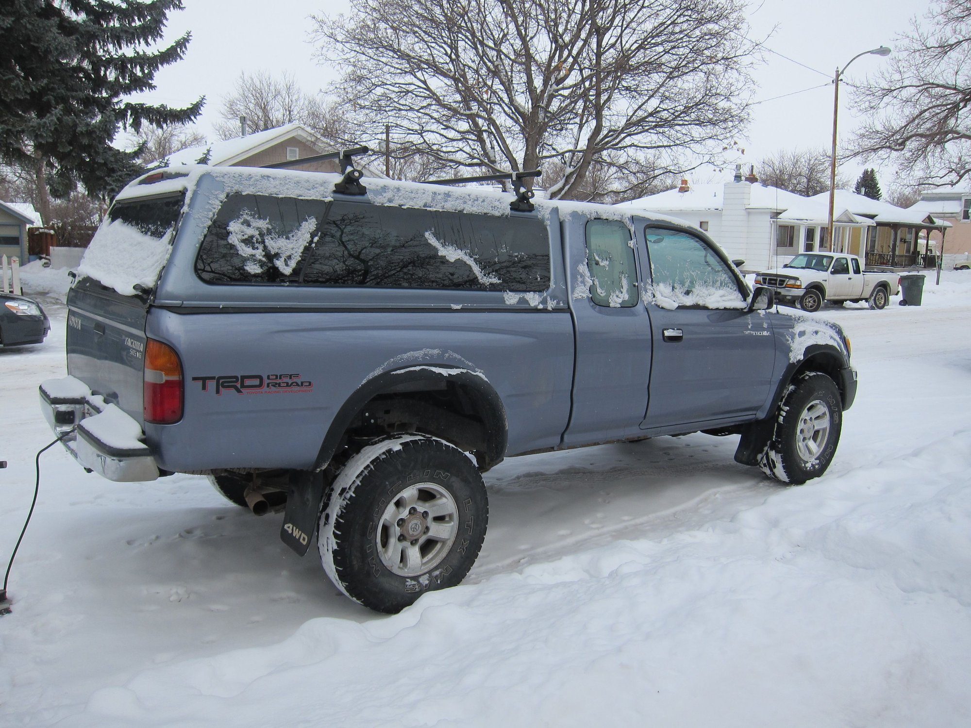

Got mine installed this afternoon. I'll post photos at some point. Went really smooth. I was worried that the Daystar cradles wouldn't fit my truck, since on their site they say they "fit most full size trucks", and all the people in the link I posted have post-95 Tacomas...but they fit just fine.
These things give my truck way more lift than I was expecting. I'll measure and post photos, but I think the max psi is 100. We pumped them up to around 60 just to check it out. At 20 it's noticeably jacked up. At 60 it had at least 4" of lift.
Pretty crazy.
Edit...I meant "post 05 Tacomas"...
Old Dec 29, 2015 | 11:51 AM
83's Avatar
83
Joined: May 2008
Posts: 4,591
Likes: 126
From: Montana
With bags aired down to just under 10psi
At 60psi
Max is 100...crazy.
I need to buy an accurate gauge especially for low-psi readings. Most gauges I've used since installing this don't start reading at all until about 10psi, and probably aren't accurate till around 20 or so. Seeing as I start getting lift with any amount of psi at all, I want to keep them as low as possible for normal use; around 5psi. So I'm getting a good quality pressure gauge, plus a nice small floor pump I can travel around with.
