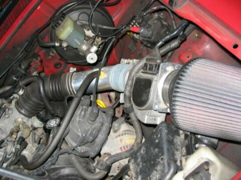

Why don't you try this? It's a K&N cone, Vibrant MAF adaptor, Vibrant 2 1/4 45 degree and home-brew brackets and fittings.

Post
truckmike,
Do you think you could give me the part number for the K&N cone? I thought about going that route but wasn't too sure because they've got quite a few with different dimensions.
Thanks
EDIT: If anyone else has a K&N cone filter on thier 2nd gen, could you please give me the part number?

Old Oct 15, 2003 | 08:00 PM
truckmike26's Avatar
Joined: May 2003
Posts: 438
From: Toronto
Originally posted by AgRunner06
truckmike,
Thanks
It's RE0930 -- six inches long (tapered cone) with a three-inch inlet -- I feel it's the largest size cone one can practically fit without too much work. I could have gone larger, but I would have had to drill extra holes and made more complicated brackets to support the air flow meter.
Old Oct 16, 2003 | 11:48 AM
AgRunner06's Avatar
Joined: Dec 2002
Posts: 2,424
From: The Lone Star State
Post
Thanks
Did you have to make a bracket to support the AFM? I'm sure I can do this because I have access to a shear, cut-off saw, and drill press. How complicated was the bracket?
Where did you get the adapter for the cone filter? I saw one at Autozone. It said that it would fit the older Supra AFM or MAF (not sure which). So I'm guessing that it might fit my AFM too. I'll just have to measure it before I buy it.
Thanks Again
Old Oct 16, 2003 | 05:50 PM
Joined: May 2003
Posts: 438
From: Toronto
The bracket is nothing more than a piece 1/8 by 1-inch aluminium bent into an "L" with some holes drilled into it. When you remove the factory pipes (it's amazing at how much space there is in there with all that junk outta there! ), the air injection "muffler" that has to come off the main air box because you'll still need it. I stuck a K&N 3/4-inch crankcase breather in place of that curved connecting hose (the one that goes from the "muffler" to the main air box lid).
The adaptor is from Vibrant (PN 1996). The 45 degree, 2-3/4-inch polished bend is also from Vibrant (PN 2880) as is the blue silicone coupler (PN 2184). The airflow meter comes off the air box lid and I attatched the L bracket to the existing holes that held it there. The L bracket bolts to the inner fender to one of the holes from the factory system.
You'll need to slice down the 45 bend lots and find a way so the 2-3/4 O.D matches the truck's factory bend from the throttle body as it's has a bit larger I.D. (wrapped a few rounds of duct tape -- shhh, don't tell! )
It's definately not a bolt-on as lots of trial fitting a cutting-to-size in necessary. But I had tons of fun doing it, it sounds wicked (especially at WOT) and gives some more power. Probalbly doesn't work as well as a true cold-air/shield system, but I like it. Plus, checking the air filter is easy! One other thing is you'll have to drill a hole and adapt a fitting somewhere for the A/C compensator hose (small dia., same location as where the air injection hose connects).
Oh, any import tuner store has this stuff and companies like Ractive and Matrix make the same parts (same parts, different brand name). Feel free to ask anything else.
