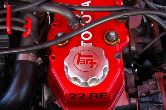

OK Welcome......What leads you to believe the Rad is bad? I would say the oil filler cap inside would be milky if there was a problem.

.....of the strawberry flavor. Coolant (or enough accumulated moisture in oil from short runs) mixing with oil yields the creamy chocolate gunk under the oil fill cap.

Oil filler cap.......Name:  2013-07-05150854_zpsee8904f3.jpg
