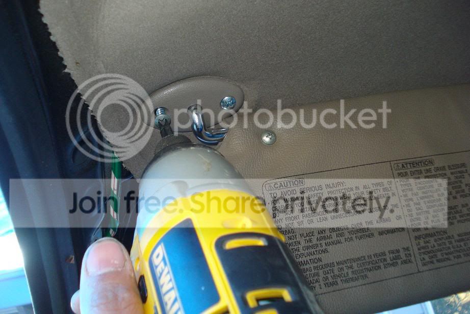

First i removed the grab handles on both sides using my trustee dewalt impact driver, make sure you have the right size phillips bit to eliminate stripping, remember it's held tight with a blue loctite tread locker..
picture shows the bottom screw close to the steering wheel. do both sides.

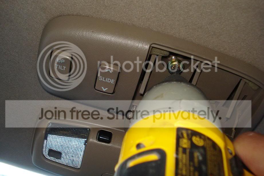

remove the sunroof control by undoing the screw inside of that little compartment, once the screw is removed, push the compartment forward toward the windshield, then pull it down, remember to pull the connector out, this requires pushing down the female connector's tab and then pulling it out at the same time..save the screw for FMU mounting.

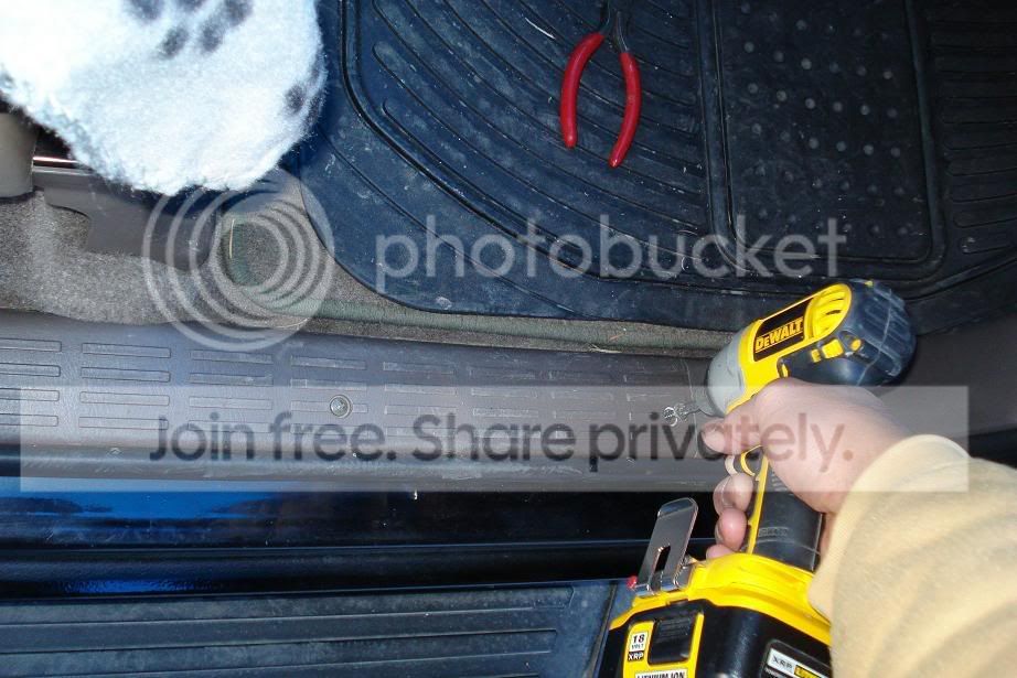

next is the removal of the door sill which is held by 4 long phillips screw. remove the sill to be able to remove the kick panel which houses the ABS module. somehow get your fingers under the kick panel then pull it towards you..it should pop off..on my 97 the ABS is on the passenger side kick panel,,,i read that it's on the opposite side on 99's and forward.
now that the ABS module is exposed, remove the two 10mm bolt to get access to the back of the ABS.

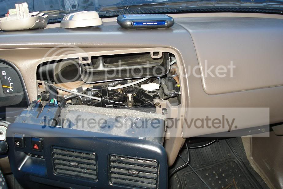

now the clock wire is accessed by removing the front dash trim for the stereo and temperature controls..behind the temp. controls on my '97 are 2 screws holding everything down, plus a couple of hold clips. remove the temp. control cover plate, then the screws and pull the entire dash off, in order to gain full access to the clock wire, few connectors have to be unplugged temporarily like the hazard and the rear window defroster.
unplug the clock connector and locate the green wire, tap your other wire coming from the passenger side pillar trim into this using your 22awg tap connector..put everything back and were done for the illumination.

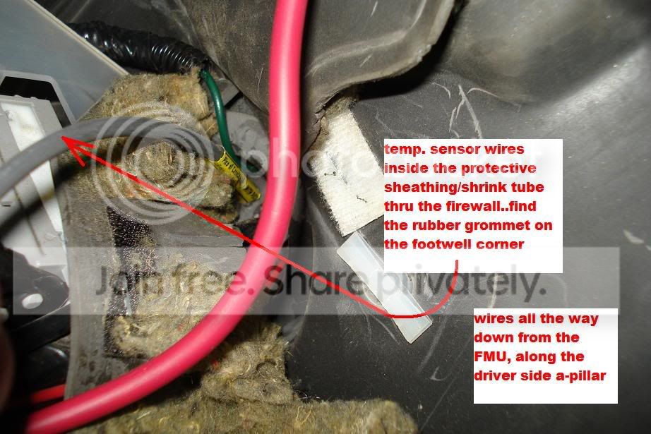

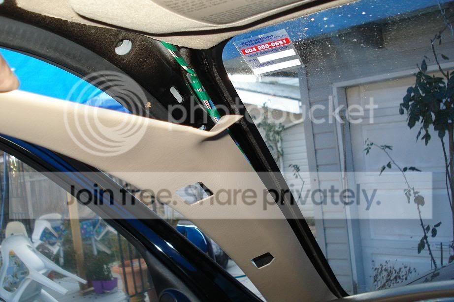

the drivers side is much easier as were only running two more wires for the temp. sensor thru the firewall and towards the sensors final location.
...so again from the FMU's location, two wires go down along the pillar, under the dash and the firewall. use your shortened coat hanger, tape the wires on the other end and punch through the rubber grommet, poke the grommet repeatedly until you know two wires can get through. Pull from the engine bay and if ready, connect the sensor and mount to its location, i left it for last..

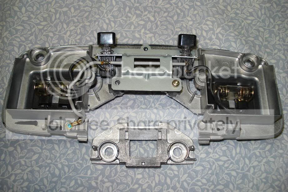

the headliner will have to be trimmed to accommodate the FMU, more than an inch towards the sunroof is needed and a bit towards the windshield(shown with the red dash lines). i suggest pre-fitting the ENTIRE unit, and verify how much will have to be taken off, take time- no room for error here. trim off until the unit sits flat against the headliner and the screw holes line up for installation. tuck all wires so as not to hinder the operation of the sunroof mechanism (if equipped) on your final install.
as for the mirror mount, remove the white male maplight connector from it. then trim off around the screw as shown in the picture below. use an angle grinder or a rotary tool with a cut-off wheel, file the edges of the new mirror mount. re-install the rear view mirror onto the newly cut mount and back to the headliner.
the FMU uses the plug & socket type bulbs whereas the stock uses the fuse style. for the maplights, I elected to use the existing maplight as the 12v source of power, the white male connector on the mirror mount still connects to the existing 12v power wire in the headliner.

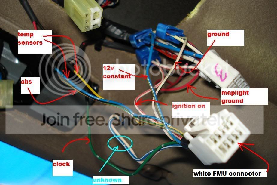

See how the rest of the wires from the FMU are connected on the picture below. remove the white connector off the FMU and tap the wires as follow:
blue -temp. sensor
yellow/black -temp. sensor, connecting these two wires to the sensor wires is arbitrary.
green/orange -abs
white/red -switch 12volt(ignition on)
blue/yellow -constant(hot) 12 volt
green -clock(illumination)
white/black -ground, i also used the ground point for the maplights
sorted, bundled and zip tied.

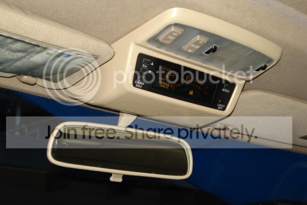

as for our finished product....
