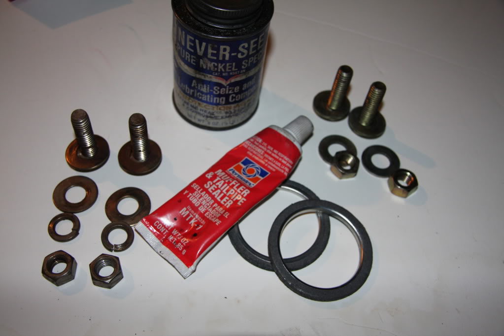

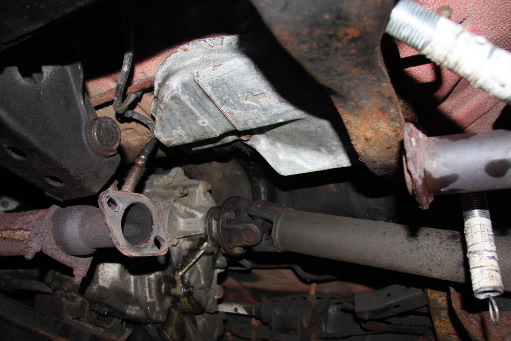

Piece of cake,
Size:  121.1 KBName:  IMG_3056.jpg
