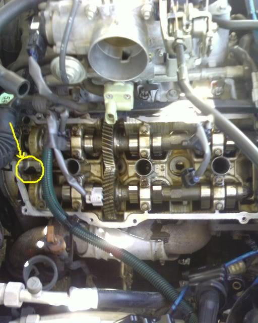

Originally Posted by vr4boy
QUICK QUESTION
is there add'l hidden headbolts on the 5vz motor? i took all head bolts off-8 bolts per side(12mm;12pt) and exhaust manifolds studs and for the life of me,can't lift the heads off-so much sludge in there i'm probably missing something.
YES
Each head has a single extra bolt, its a long socket head cap screw that uses a 6mm hex I think. The passeneger side is at the back of the head near the firewall in a pretty deep counterbored hole. The drivers side is at the front of the head it the symmetrically same spot.
Edit: I attached two pictures that show the holes in the block they screw into, and the approximate location on the passenger side head.
Attached Thumbnails engine spins effortlessy-img_0148_small.jpg   engine spins effortlessy-img_0157_small.jpg

You can actually see the hole for the screw in this picture. Why it's there I dunno, maybe to help seal the head near the coolant passage right there (although it has a low torque spec), or perhaps to foil the attempts of DIY mechanics like us.
