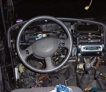

thanx for nothin guys! just kidding, without you i wouldnt have done the cool blue signal lights while i had everything torn apart i thought you guys might wanna see how much of my car i had torn apart...

Dang, you really tore into that dash
Sorry, I don't have the answers for your electrical stuff.
Sounds like a lot of work.

Wow you did tear into that thing. I have had mine close to that once or twice in my gauge escapades. Gotta do it partially again tomorow. So did you ever get your problem fixed that you originally started out to do?
