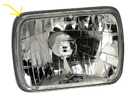

I don't think it will look right. The 92-95 grill is molded to fit those lights. Putting 90-91's in there isn't going to look right.
90-91:
92-95:
Now, I DO SELL these for 90-91's.
It's a new clear housing that takes a H4 bulb. They also fit 90-91 4Runners and this is the latest version.
If you want more info, click on my email in my sig below.
