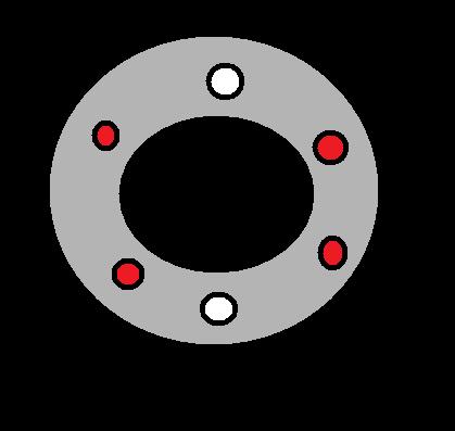

ok, not perfect but to the point.. red indicates where I have lugs, white indicates no lugs

If the two bad studs were next to each other, I wouldn't chance it. Since they are across from each other, you should be fine. What happened to the bad studs?

I would feel better if the spacer was on a rear wheel but not a front. The fronts have more forces put on them and if you lost a rear wheel it's not as bad.

Wheel studs are seated in wheel spacers by the knurl. If they are stripped the wheel spacers are junk now. Get a new pair.
