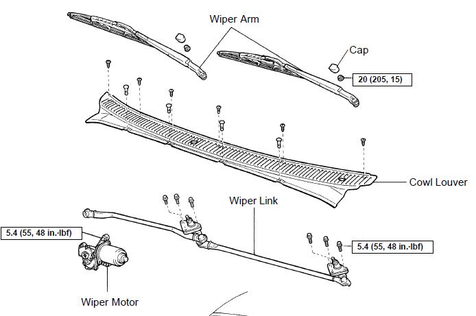

Hopefully a picture is worth a thousand words. I think the center linkage has come unstuck on you. Good luck, that can be a bear of a problem when it's cold out. I remember the cuts and bruises from trying to reattach my wiper motor through it's mounting hole (without taking the cowl off).
A sure sign of this is if the driver's side wiper can be moved by hand with the motor off. But then again, it might be all jammed up in there and not move by hand.
There is no way this is an electrical problem if the passenger side works and the driver's doesn't.

Thanks for the help, turns out the nut was just needed to be tightening down.
