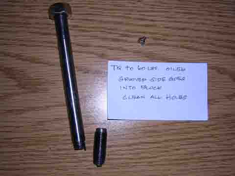

Heres' some pics of my fun.
http://community.webshots.com/user/darkronin619
Do to the DOA album. You'll see the carnage.
I did tighten everything in proper sequence at 45 degrees at a time.
It took me about 5 passes to get to 60 lbs torque. The driver side went on perfectly. I did have to go to a tool shop and find a 3/8" drive thin walled 11/16 socket though. I got an adapter to 1/2" so I could use my torque wrench. It was 2nd to last to torque down. The nut was turning nicely. 60 lbs (at lest for me, I'm fairly strong) isn't too much effort. This felt more like 25-30 lbs when it snapped.
The quality on the studs might be a little suspect. I laid all the studs out, (wish I had my camera then) and they weren't what I call 100%/perfectly even in length. They didn't seem to vary greatly, but they did not look like a replica of each other. I would guess they are hand made. Not CNC'd. It might have been an illusion with the threads though. Also, the nuts would go on a tad rough. I cleaned all the studs,nuts, and block holes prior to install. The studs went into the block no problem. The nuts would seem to bind a tad in places if you were finger tightening them. But not bad.
The studs are supposed to have a ring/groove around one end. That end goes into the block according to the "instructions".
2 of the 16 didn't have a ring/groove. The ends that go into the head had a mark written on them, so I figured if the other 14 had the same mark on the head-side of the stud, then these 2 should be no different. Maybe someone forgot to put the groove on these 2? Well, it is interesting that 1 of the 2 without the ring/groove broke.
Now its' Saturday. It is raining like a mutha here in San Diego. I don't want anyone to think that I am talking smack about DOA or thier studs. I am just telling/showing what has happened to me so far. I placed the order last Saturday. They shipped Monday via USPS, and I recieved them Thursday afternoon. With shipping it was $275. Now for this price; well, I'm a bit burned right now. :wtf:
The kick in the balls in this whole epic of mine is that when I went back to call Tim @ DOA, their web page has a notice that they will be closed until May 3rd. I guess you can't beat timing. I have called and emailed, but there is no message machine, and no reply to my emails. If anyone lives near DOA, or knows Tim, could you please drop him a line?
This started as being a head gasket fix, and now a month and some change later, I have had to get new heads as mine were toast, + all the assorted pieces and parts. I should of had my engine back in my rig this morning and starting it up. Instead I'm stuck. For the amount of time and money this has cost me, I might as well have driven the engine until it croaked and done the 3.4 swap. God I wish I had a manual tranny. I would have done the swap from the start.
Sorry about the whinning folks. I am just getting sick and tired of looking at the engine that never will in my garage.

You'll see that I picked the lines on the paper and the line/groove around the bolts to orientate them with them with each other. You can see some variences. Ohh, when I removed the studs, the nuts were binded on them. I had to double nut the other side to get them off. I wasn't too easy.
