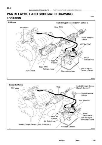

My 4runner has the CA dual cat setup and was purchased new in VA. CA 4runners had two cats rather than one and an air flow sensor.
There is no reason that a CA 4runner would not be fine driving around in Colorado. I don't see why the ECU wouldn't just adjust for the thinner air. Plus, the tallest mountain in the lower 48 is in CA and there is pleanty of high country that CA vehicles have to handle too.
