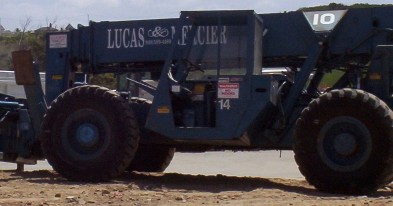

I've considered using a 4cyl John Deer or Cat out of the forklifts I drive all day long. They look about the same size as a 22re and there so reliable its not even funny. Would be alittle required but shouldnt be too complicated.

don't those only have like, 25 horsepower?

I would never put in a forklift or CAT or similar engine. You'll find the engine undrivable: low on horsepower, small powerband etc. Most can't be turbo'd since most don't have oil skirts for cooling the pistons. You'll be stuck with a swap that's only good for hauling stuff around your backyard.
