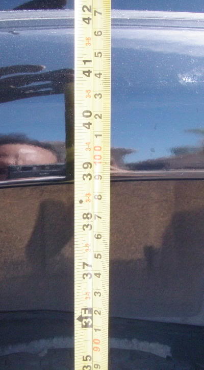

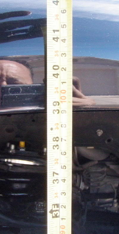

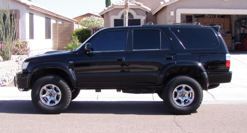

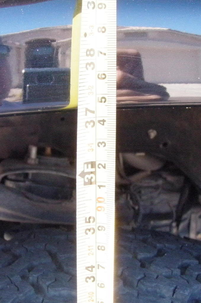

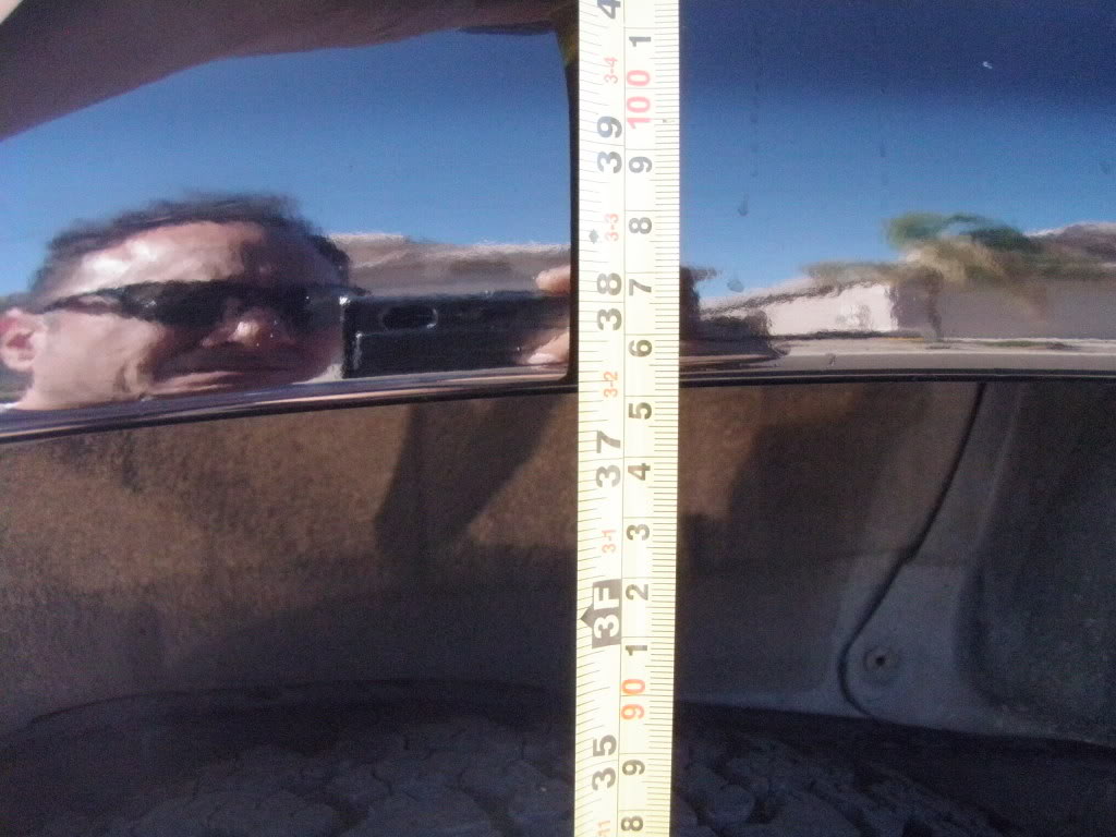

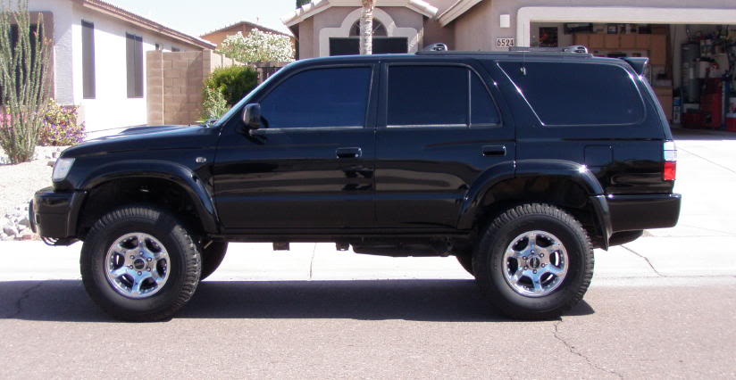

I installed my 1" BL yesterday and wanted to share pics of the transformation (Daystar to OME and finally to BL). The install was pretty easy. I actually went real slow and took about 3 hours. Since we don't have much rain and no snow here in Phoenix, none of the bolts had any rust and were very easy to remove. I ended up reusing one of the OEM bolts for the mounts at the front of the cab since the threads on the 4Crawler bolt looked like it would bottom out. I also didn't use the bumper relocation brackets that I ordered with the kit. They aren't really needed. I just drilled a 1/2" hole 1" up on the OEM bumper bracket and it worked perfect. I'm very pleased with the overall look since adding the OME lift and BL.
Comparison Pics:
Daystar 2 1/2:
OME 3" Lift:
4Crawler 1" Body Lift:

Looks great. I really like my OMEs, they are a little stiff on road like you say, but when you air the tires down to 10-15 psi for off road, the OME set up is really plush. Rock that 4x2 man, at least it's locked! I drive around a lot in 2wd with the rear locked, it will handle a lot still.

The rig looks awesome man. I'm jealous of that black with the slick flares. And the pics are great.
Those pics really show what difference 2.5-3" makes and what a 1" BL can do.
Good reference pictures for people. And pretty cool to know my rig will soon be sitting at that level.

Great work man! I really love Black T4R's! What size tires are you running?

Thanks. Tires are BFG All-Terrain 285/75/16....

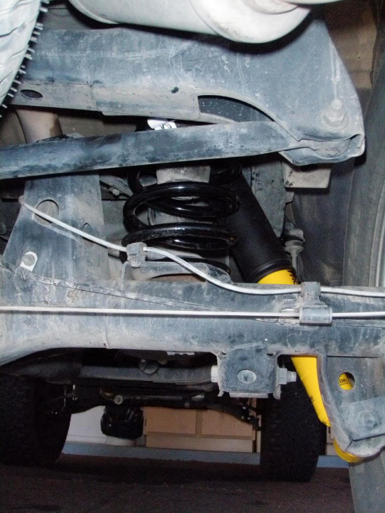

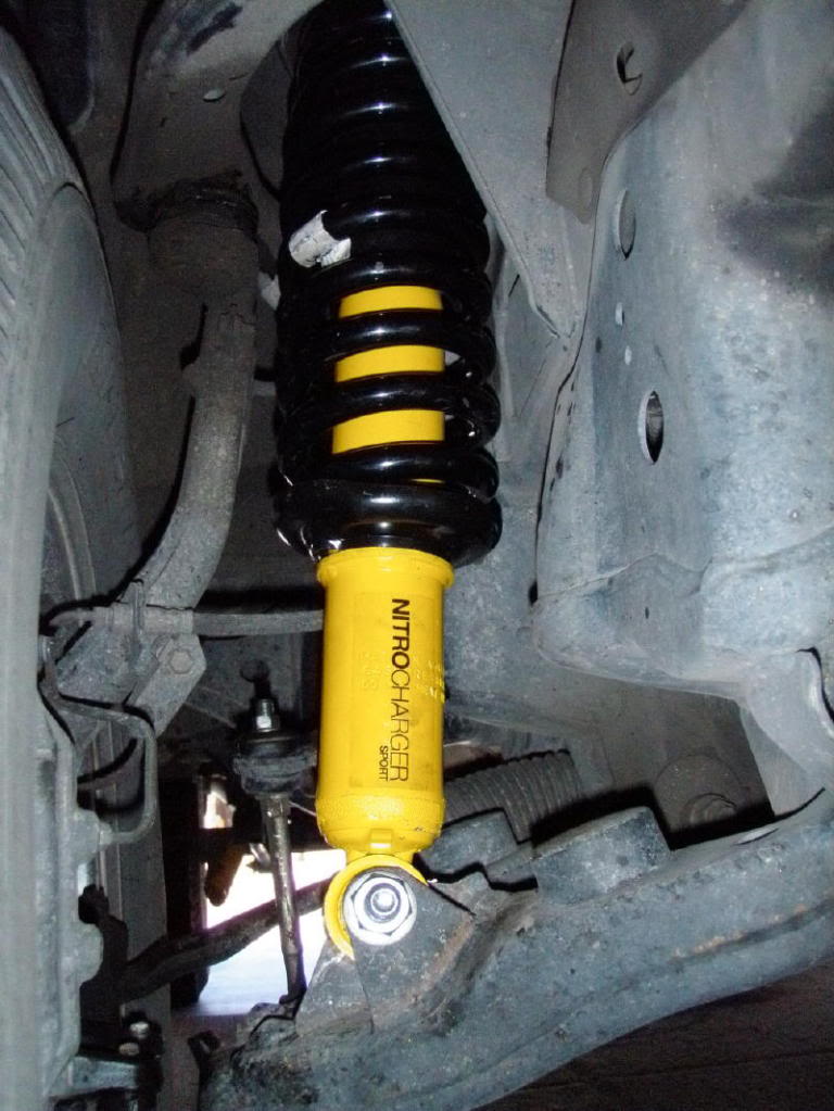

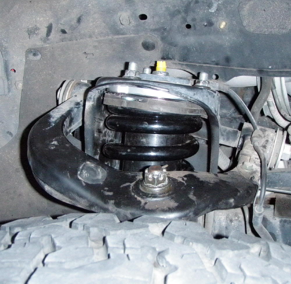

I'm very please with the look and quality. It sits nice and level. It is more stiff than before. I feel all the cracks in the road, but it's a good firm ride. I forgot how much of a headache the front strut assemble can be to re-install. So...this time, I unbolted the swaybar end links and the 4 bolts that hold the lower balljoint to the control arm. Once the control arm was loose, I just stepped on it to give me the extra space I needed to fit the assembly. It worked real nice. I ordered my 1" body lift from Roger Brown (4Crawler.com) last week and will take pics after install and share them.
Below are a few pics before and after. I also have a pic with the OME in the rear and the Daystar in the front.
Oh...and if any one is interested, I have the Daystar lift for sale on Ebay:
http://cgi.ebay.com/ebaymotors/ws/eB...%3AMESELX%3AIT
Daystar Lift:
Daystar Front-OME Rear:
OME Front & Rear:
Front-Before & After:
Rear-Before & After:
OME Front Strut Assembly:
OME Rear:
