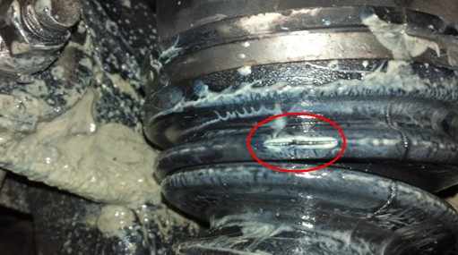

I was out on the trail earlier today when I looked under and saw grease all around the inner CV. I figured it split from lifting the front 2.5" some months back on (maybe) original boots. I couldn't see the cut at first, but found it when I got home. I was expecting it to be in a groove, but it was at the outer bellow edge (see photo). I would expect that it would tear in a groove if it were age related, but could a sharp rock or branch have done this? Trying to decided whether to replace/reboot both sides (if age related) or just that one side (if freak accident). Boots seemed pliable last I checked, but I'm not that experienced.

It's hard to tell the exact source of the leak.
I will say this, if the CV joint is otherwise unbroken and serviceable, go ahead and replace the boot. The OEM CV joints are marginally stronger than a parts store unit.

Do you mean source of the cut? The source of the leak is in the photo (replaced photo with cut circled).

OK, so I cleaned everything off and took a closer look. It really does seem a branch or something cut it. I stuck my finger into the slit and it did not crack further at the edges the way I would expect if the rubber was bad. However, I did find both inner boots are cracking near the small bands so looks like I'll be doing both sides.
