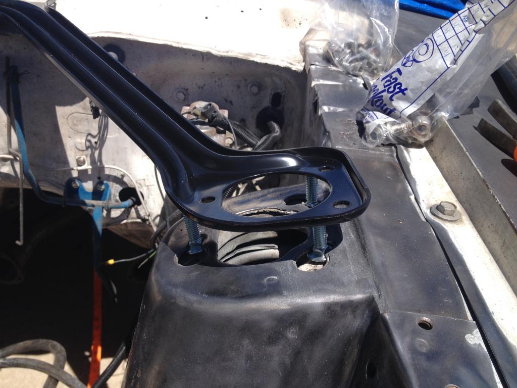

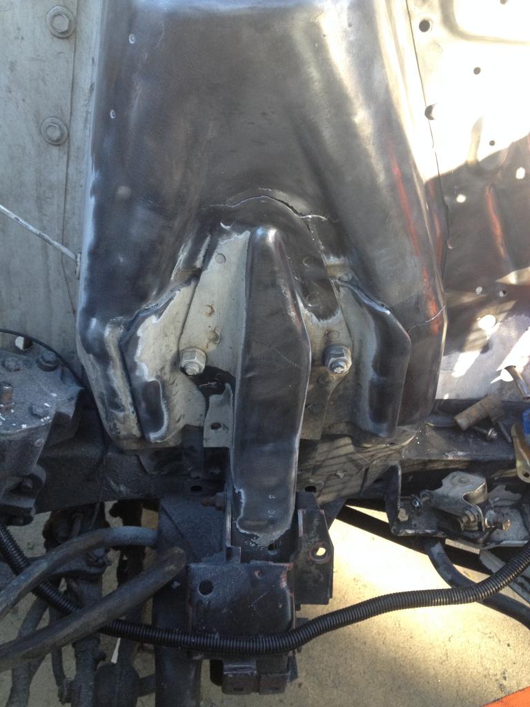

Trust me, I've repaired worse:
Showing the crack:
Original picture:
Granted, this is in a near 50 year old vehicle. There's a couple things you need to take into consideration. If the tower is cracked, guaranteed something else in the chassis has shifted. It doesn't look like the crack has any separation or metal fatigue. You might be lucky!

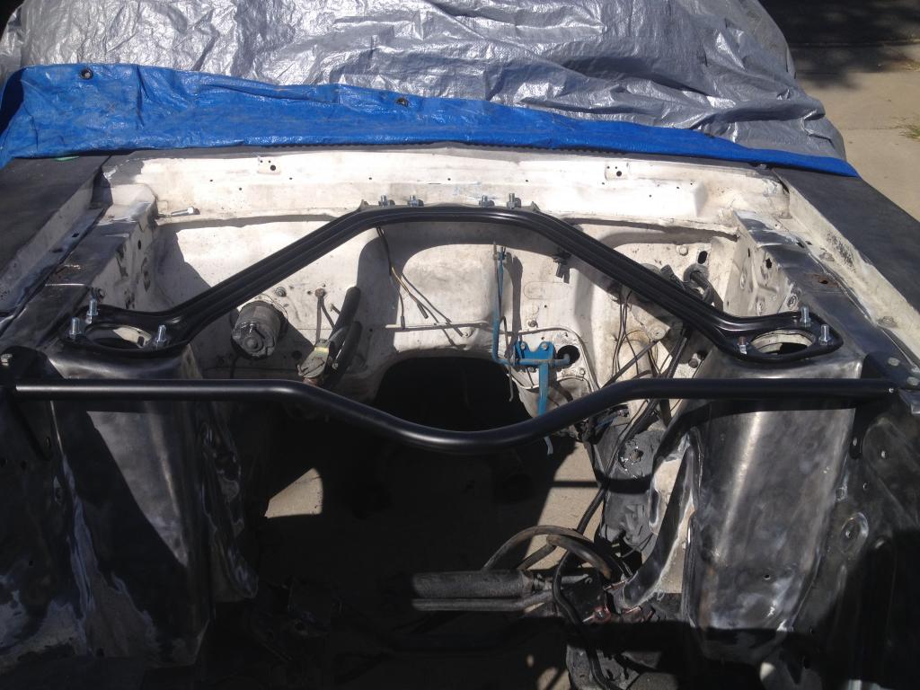

After some serious wrestling and a plethora of ratchet straps:
Here's what I would do:
take all the weight off of that side ( as much as possible, obviously don't want to pull the motor like I did on my 67 )
weld it up.
You should pull the strut out and see if there's any splitting on the inside of the tower.If there is, roll a bead down on the inside and the outside, grind the weld smooth on the visible side.
