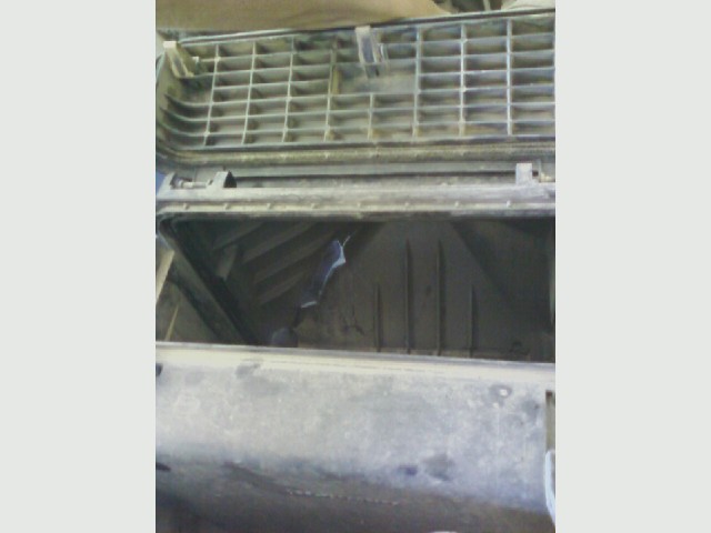

I have about a 3 inch crack behind my air filter on the air box. it needs to get fixed because it is behind the filter.... I was thinking about jb welding the plastic back together. but i do not know how sensor safe jb weld is. any ideas
the pic shows the crack

could you torch a piece of metal and use it to "weld" the plastic together?

You can also epoxy it back together, to close up the hole. I have seen some plastic-weld stuff works pretty good too.

Aluminum duct tape, easy and practical.

PO drilled a bunch of holes in the bottom of mine. Used silicone to plug them up.
I would melt it back together, then use silicone or something like that to seal it off.

Duct tape. Or sensor safe blue RTV and glue hte pieces back together

you don't HAVE to use sensor safe glue, it just needs to dry before you use the truck! wouldn't hurt to be double sure though..... go to home depot or autozone and get yourself a new intake and add a cone filter! what a perfect excuse to do a quick mod....

So as for a fix i took a bunch of grey rtv, and "glued" well I mean siliconed it back together. It is a custom silicon mounted air box now...... It flexes lol. I think i am going to scrape it off soon and epoxy it.

I just took off everything to clean my TB and cleaned everything else while I had it off. Found a crack in the same place. That mount behind the crack is the only good one left on mine (I guess that would put a lot of stress right there). I fabbed up some more mounts and I'm going to epoxy it back together. Shouldn't be a problem anymore.

I used Gorilla tape to hold my air cleaner housing closed after the stupid clips broke.

yep mine broke like that too all i did was cut some thin strips of metal a few screws and some blue sensor safe rtv let it dry and its been fine
