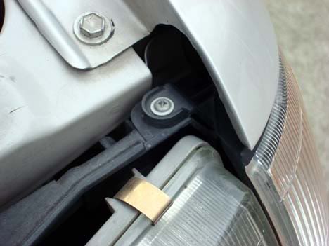

First, open the hood and remove the hold down screw for the corner light.

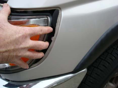

Grasping the corner light, pull it directly forward. It may be a tight, snug fit but you will eventually feel the lense begin to move and then it just lets go so be ready.

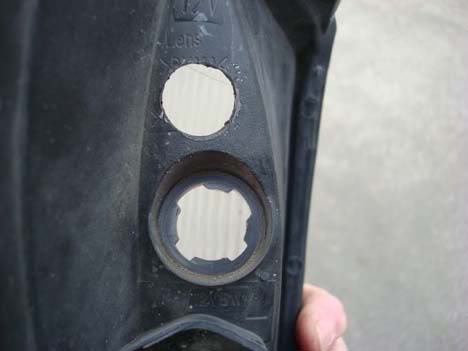

Twist the socket and remove from the lense. Locate a point approximately 1” above the OEM socket hole. Mark the center most position with a pen or Sharpie. This will be where you will drill your pilot hole with the 1/8th inch drill bit. Next you will need a 9/16th inch drill bit. I used a wood style bit mounted in a drill press. If you don’t have access to a drill press you can do it with a corded or cordless drill. Line up the point of the drill bit with the pilot hole and slowly drill out the new mounting hole above the OEM hole.
Trim up the edge of the hole to remove any slag pieces of plastic from drilling. I had to use a couple of Q-tips to remove some of the tiny bits of plastic slag that were being held by static electricity on the mirrored surface of the lense. Remove all of the shavings that you can. Ensure the hole edges are free of any remaining strands of plastic.

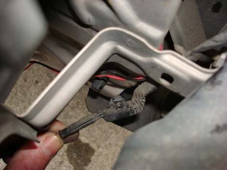

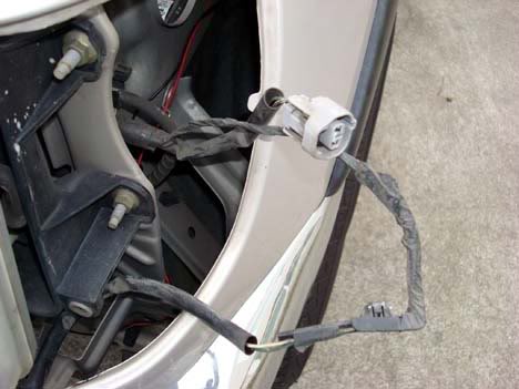

Disconnect the plug from the turn signal socket. There is s small tang that will need to be depressed in order to pull the plug free. Use a small tipped flat blad screw driver or a some other small tipped tool to press the tang down. Looking down from the top you will see the blinker wire is attached to an “L” shaped piece of plastic. Use the med tip flat blade screw driver and pry the clip out of its mounting hole near the bottom of the front support..
Pull the wires up through the opening where the corner light is attached to the fender so you can work on the wires.

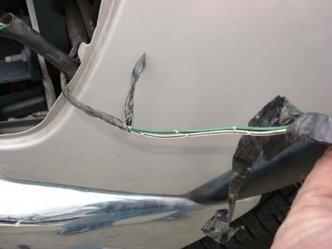

Remove the tape securing the plastic mount from the wires. It may require cutting the tape so if you must do this, be careful not to nick the wires. Remove part of the tape from the wires themselves exposing approximately 6-8 inches of the wires.
The wires exposed are identified as follows:
Left :
Green/Black +
White/Black –
Right:
Green/Yellow +
White/Black –

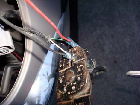

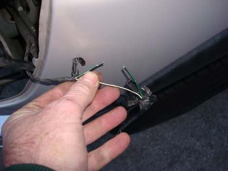

First cut the green wire and strip approximately ˝” of the insulation from each end.
Insert one end of the blinker wire into a crimp and crimp. Insert the second end along with the red wire from the new blinker and crimp. Ensure you push the wires in as far as they will go in the crimp.
Do the same with the remaining white/black and black wires.

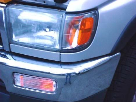

Install the mount screw, install the bumper blinker assembly and you’re done!
