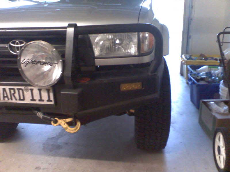

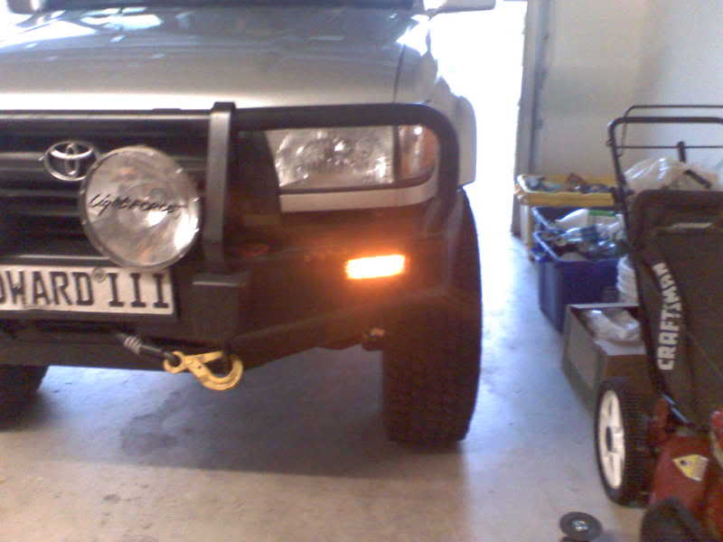

What does this "mod" actually do? I dont still dont get it....are you running an aftermarket bumper?
On my 95 Tacoma, the turn signals are on the front of the bumper and cannot be seen from the side. I like to let others know which way I'm going at a four-way stop. (if others would only do the same...)

Yes I have an after martket front bumper, that is why I relocated the turn signals. As far as Illinois requiring parking lights, I am not really sure about that. Maybe I will have to look into it, I don't want to get pulled over.

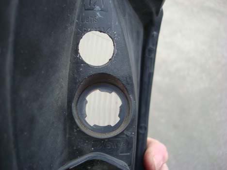

okay the mod as detailed extensiverly by RitzyRunner is to add a turn signal blinker light in addition to the corner marker lights so that when the turn signal is engaged the bumper indicator and the corner marker blinker both blink.
The normal corner indicators remain intact as your parking light, but they are supplemented with a turn signal bulb when your lights are on and the turn signal lever is pushed/pulled.

yes corners are still parking lights and a turn signal also
Originally Posted by aeverett08
so do the corners still operate as parking lights also? when the headlights are on, and assuming the corners are on as well, like the original function, if you turn the blinker on, do they stay on and the 2nd bulb blinks, or do they completely dim and blink like the lower oe bumper signals?
yes aeverett-the corner marker lights remain intact as parking lights-the addition of the second bulb serves as an additional turn signal indicator-in tandem with the ones at the bumper.
As the bumper turn signals blink-the second bulb encased in the corner lens also blinks so that folks can see from the sides what you are indicating for your turn.

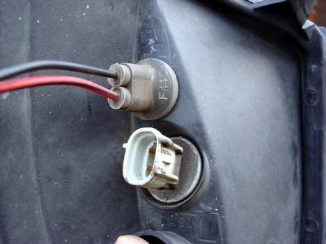

Thanks Ron! I was reading my email and saw the question about my mod. Sooooo .....
To answer you aevrett08 from the guy who did the mod on this thread, the answer is in the pictures and is still YES. Everything about the corners is still factory function, the same OEM confiuration. I ADDED the Honda turn signal sockets to the OEM corner lights. When you turn on your parking lights/headlights they still perform the same function as before. If you go back up the page and READ the post about my install you will find that I drilled out a hole in the corner lights to accept the Honda signal rubber booted sockets.
I even walk you through the prep, install and hook up. You never touch the OEM corner lamps so they still function as your corner side marker parking lights.
By installing the corner blinkers, all I did was to help make my truck a bit more visiable from the side. Most all vehicles use a combination bulb such as an 1157 dual filament bulb. some have done the mod using just such a bulb but trying to fit up the socket is a bit more difficult and to do it properly you need to cut notches in the holes to allow the new 1157 sockets to twist lock in place. Otherwise you are looking at gluing, silicon sealing ... just a real head ache if you need to replace a burned out bulb, so thats why I went with the Honda blinkers, no extra cutting, no alignment issues, no messing with sealer or leaking water into my corners when it rains and I can replace the bulbs very easily. Even use LED bulbs too!
To further enhace my vehicle visiblity, I also did an addition of LED side blinkers from a 2005 VW Beetle. https://www.yotatech.com/forums/f126...lights-141517/ Anyway, I hope this helps you to understand what the corners on my truck actually do. They are still the OEM parking lights with an additional set of bulbs mounted seperately in the same housing that are wired into the front bumper turn signals. If you were to replace your factory bumper with some sort of aftermarket type bumper that did not have front mounted turn signals you should still be legal in most any state with my mod. Enjoy!

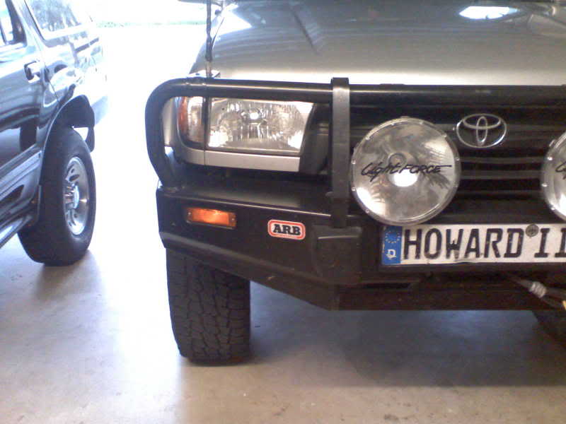

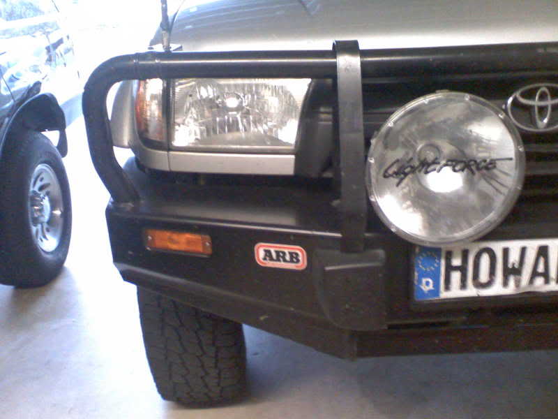

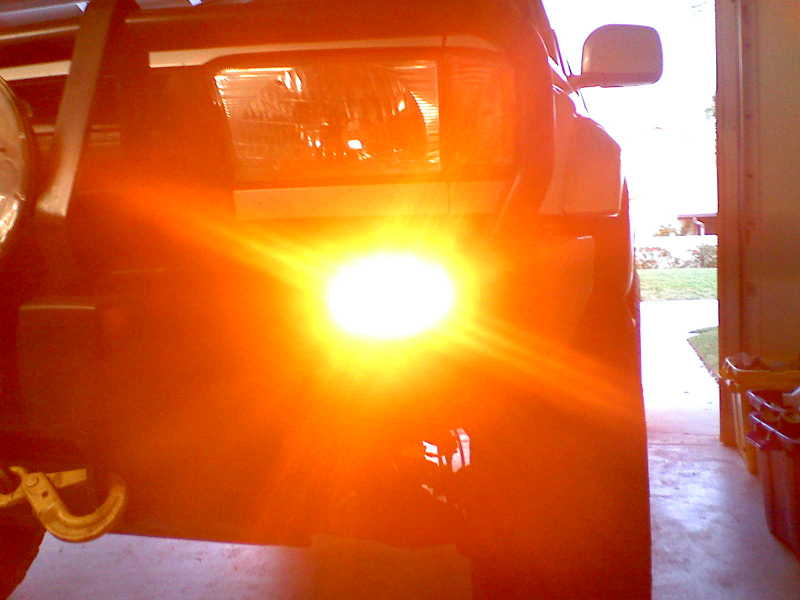

Teaser and comparison
Level with turn signal
I have been long awaiting a pair of whelen TIR6's to come available used (new $100ish ea). I found some on ebay for $40ea. and jumped on them This mod was to an ARB and required some grinding of the original opening top and bottom only. It required bending the old mounting tabs back as to utilize them to hold the new lamp in place, that and a snug fit ensure it won't be going anywhere.
