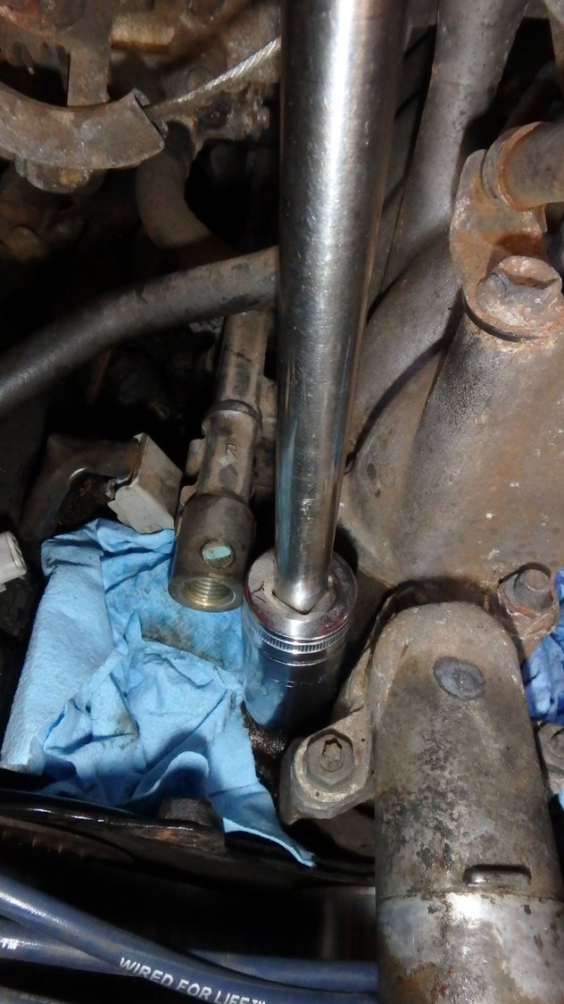

Here are a few photos of the location and exchange of the Coolant Temp Sensor on my 96 4Runner V-6
The sensor sits just behind the timing belt cover on the left if facing the engine.
You will need to remove the coolant, upper radiator hose and cover.
This is the location. It sits just under the fuel rail.
Disconnect the wire. These are fuel rails are pressurized, so just be careful NOT to yank on them when loosening. The aluminium fuel injector lines could break.
You will have to remove one bolt and loosen the other one in order to swing the fuel line out of the way.
I put shop towels under my fuel rails to catch the small amount that comes out. I used a 21mm deep impact socket on a ratchet to remove the sensor...
and a 20mm deep to install the new one.
This is the old sensor
Before removing the sensor i cleaned any excess gunk then once removed I used a swab to clean a little more making sure nothing went inside.
This is the new sensor installed and the fuel lines and wires all connected.
