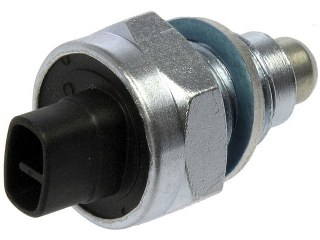

Originally Posted by TheDurk
5-speed has relay on passenger side. Auto has 4wd ECU on driver side. Never both. Your fault could easil be a T/C sensor switch. Check those first, before messing with relay/ECU. You could MacGuyver a 2-way switch to the VSV's to control ADD from the cab, but it would be more work than doing it right. Last resort only.
Hey thanks. Is the the T/C sensor switch?1998 4runner 3.4 4Wheel Drive will not engage-8215-05170687-1228439.jpg]
I replaced it already.

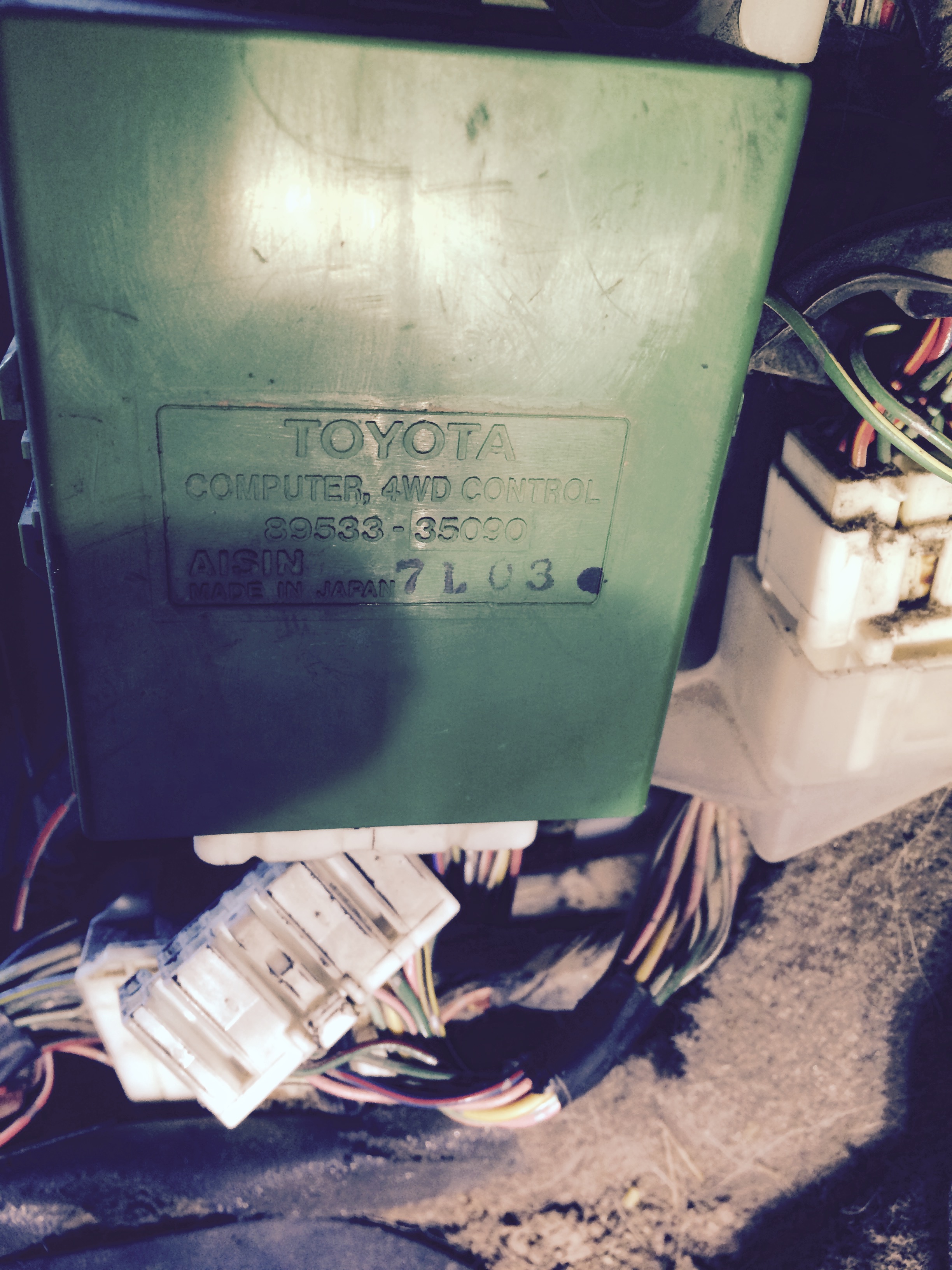

Ok one more shot at this. I have verified the t-case selector switch is properly grounded on one side, and there is continuity on the other side to the 4wd computer unit shown in the picture. However still nothing when I push the T-Case selector switch. However, when I run 12v power into the wire that goes from the 4wd computer unit shown in the picture to the 4wd side of the VSV, 4wd engages. I'm thinking the problem is in that 4wd computer unit. Signal is going in, but not coming out. Any thoughts? Thanks.
