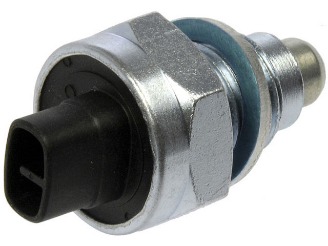

Hey thanks. Is the the T/C sensor switch?Attachment 103794]
I replaced it already.
That looks like the back-up light switch for a 5-speed, which sits low down on the trans. On a 5-speed, the T/C sensor switches are the same mechanically, but have a short lead to a plug, instead of having the plug built-in. Go rearward to the T/C and higher up--one on each side.
The above is true for a 5-speed, and I would think applies to all j-shift T/C's, but I don't know what the switches on a multi-mode look like.
You need more than the push-button input for the 4wd ECU to call the front diff by switching the VSV's. It needs to know if the T/C actuator has engaged the front drive shaft to the T/C. That's what those T/C switches do.
