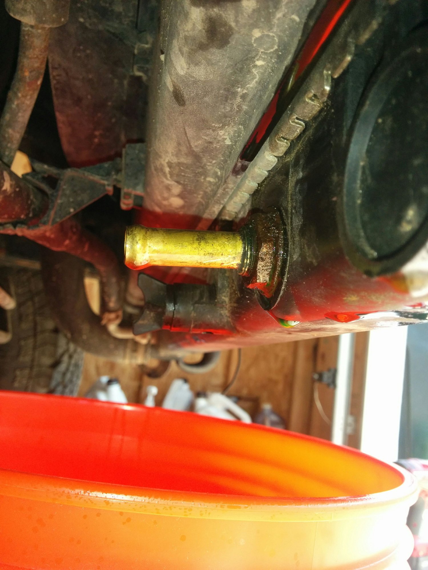

So I dried everything up and waited a day to see what exactly was leaking from where. From the pic below you can see that the nipple for the trans line is dripping red transmission fluid. But the nut that is holding the nipple is dripping green coolant! Not sure what to make of it. Any thoughts?

U needa new radiator.
Plastic/aluminum ones are not reliabily repairable.

The nipple is dripping (not leaking) transmission fluid because that's what goes through the bottom part of the rad.
It's dripping because you took the hose off. If the rads leaking then you should change it.
I'd do it soon in case it does leak into the transmission cooler part.

In the pic you can see the far right most three crimps are damp and darker. Your rad is leaking somewhere above and coolant is collecting at that fitting as the lowest point.
If your trans dipstick is still clean and red, I don't believe you are suffering a milkshake. More than likely just an old rad that needs to be replaced.
