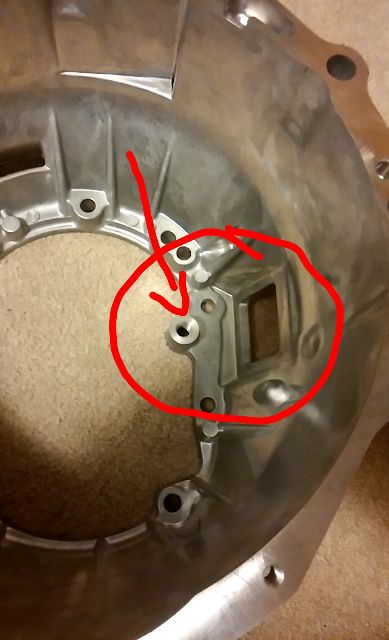

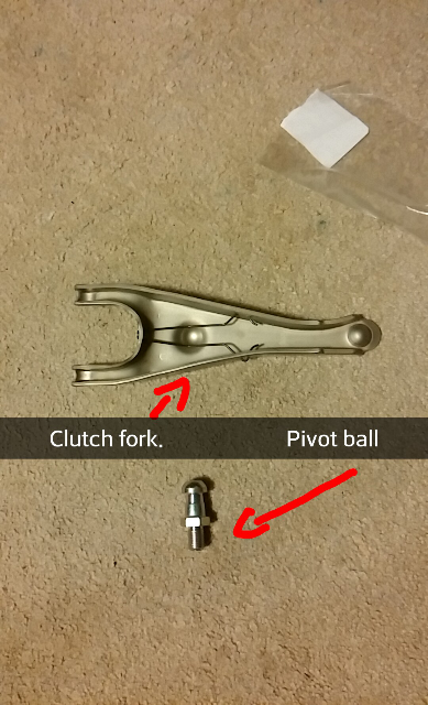

Does your clutch fork have alot of vertical play? Could of come loose off the pivot ball causing it to bind, ive had the ear on the inside of bellhousing that holds the pivot ball break off and i had the same problem, tuff to shift and the clutch wouldnt fully return unless i picked it up with my foot but the slave and master were fine
Not alot of vertical play but a little. When the slave is out it moves back and forth quite a bit without any resistance. Just loose and didn't seem right. I tried looking in with a mirror, but can't see enough.

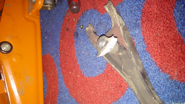

I can't see second pic but is the left, bottom end of the fork broken off in the first pic? That end of fork looks shorter.
Your problem sounds similar.

The forks not shorter, ill take some better pictures, at this point i would say your going to have to drop your tranny, the only way to really see whats happening unless you have a scope

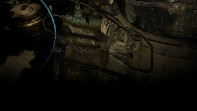

Great pics! Thanks! I'm pretty sure I saw the pivot ball via my mirror. Mine seemed to be ok, but symptoms similar.
When yours was fixed and before you installed the slave, did you notice if the fork was held pretty firmly in position? Mine moves back and forth easily. Seems loose....no pressure on it until I try to activate it, then I can't move it past the loose range.
When slave installed and clutch pushed, the end of the fork only seems to move about an inch and the master cylinder flexes up at at the firewall as there appears to be resistance.

The fork shouldnt move the full lenth of the square on the bell housing it should only have minor play, the pivot ball could still be fine, the spring on the fork could of broke letting it move freely, i personally didnt spend the money on a tranny jack but my setup is a little different because its been sas/lifted, i have heard the harbor freight ones will get the job done
