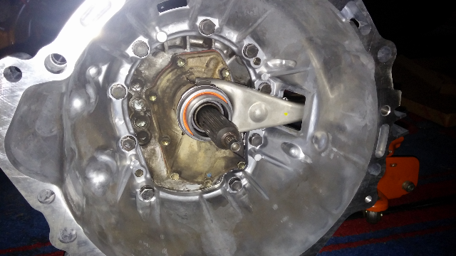

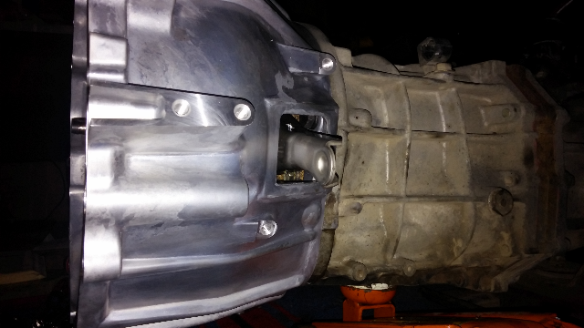

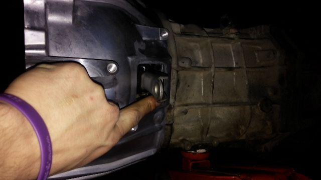

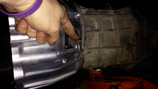

I got everything back together and i checked for play in the fork, i have maybe not even 1cm up and down play wheen i apply pressure on the fork, when i apply pressure to the throw out bearing i have 0 play on the fork up and down
Congats! Looks like a new bell housing? What about back and forth movement of fork...you know...forward and backward.
I'd be curious to know how much fore/aft wiggle after the tranny is in the truck and the pressure plate is applying the pressure to fork, but with no slave. In other words, everything assembled except slave cylinder not installed.

Is the clip installed between the release bearing and the fork? I can't see it in the pic.

Yeah everything installed right thedurk, im just posting photos to help dmac
