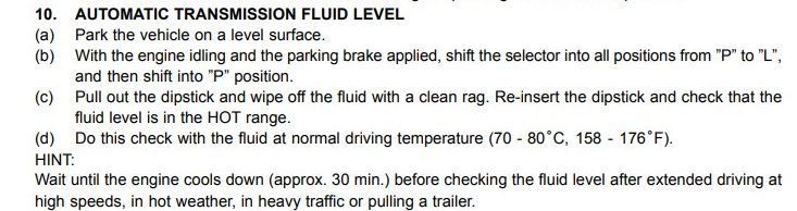

From the FSM, General Maintenance, Under the Hood:
Is this any help?
