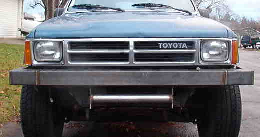

ok, so--- as some of you know, i nailed a dog with my 4runner last month and the bumper was destroyed, so i just had the most super heavy duty bumper i could think of made for the 4runner. Its made of .188wall 4" square tube and .30 wall 4" l-bracket.....GRRRRRR dont even try to dent it!!!! ----- Aaaaand, if that wasnt strong enough already, we put a piece of .50 wall cold rolled steel tube between the two supports-- just in case i feel like ramming a tank or an armored car or something like that!
what do you guys think?

Holy crap man, thats beefy. I suppose a gunner position is your next mod.

I'm thinking that if you hit anything with too much force, you'll be bending your frame rails. The trick is to get a bumper that will bend/absorb the impace just before bending the frame rails. If you I'd rather replace another bumper than screw up the frame.

Geez, what does that thing weigh? Do you need to get strong T-Bars now?

I think it's ugly as hell, but I'd sport one.

I like it. It wont win best of show but functional as hell.

hey tricktoy, strengthening the frame rails is next week-- im going to cut the front of the frame out that the bumper mounts to and put some more square tube in its place--then there will be braces from the new frame crossmember to the a-arm mounts instead of the flimsy stock skidplate.
by the way, it wieghs 100lbs-- took two of us to put it on the truck. and i like the fact that its ugly-- i keep waiting for a little civic to do the "cut you off and slam on the brakes" move in front of me.
gadget-- i doubt that anything could break a 4" cold rolled L bracket that is not an explosive or a military vehicle--- the frames on big rigs arent even that thick...but if a rock basher wants to experiment....im game!

The down side is, if the bumper is so strong, then in a crash somthin' else gives, like the frame:pat:
