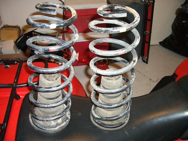

i have some coils that came from a o1 4runner sell them to u for $85 + shipping
Attached Thumbnails Cheapest effective fix for sagging rear on 99 Runner-picture-020.jpg
