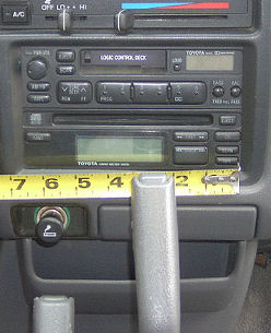

Somebody can measure the width and the height labeled X and Y (Hole measures) for me? So I can make suppositions if one 7'' screen will fit hehe.

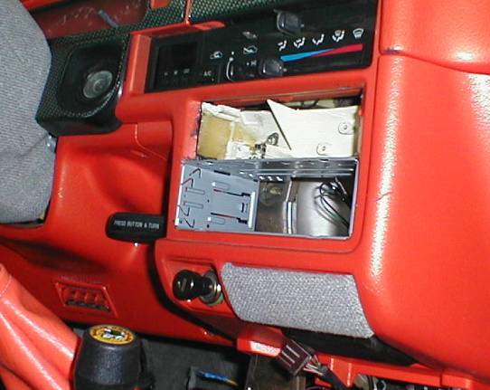

A double DIN opening is not ACTUally double DIN = you can't put 2 DIN radios in it. Morelike 1 3/4.... I had to do some major surgery to get the inclinometer in there, I could only cut down the clinom just so far... I'd measure mine for you, but it's not stock size any more.

I trimmed out above and below the opening right to the dash structure. Probably took out 3/16" each. Then used a hot blade on a soldering iron to reshape the opening. My radio bracket is touching the bottom of the molded structural piece, and the inclinometer is touching the structure above, I cut the case to the point where it is exactly as high as the dials themselves. I could not take out another 1/16" of any part!

Okay, I just measured mine. After I trimmed the opening as large as I could (as mentioned above) I have 4 3/16" of height.
Pic from when I was fitting the inclinometer-you can see inside the upper opening where the dash structure is (it's orange too because the dash was out when it was painted.) I trimmed the bottom in a similar manner and installed the stereo as low as I could get it.

i took a couple pix that included some dimensions, i hope these help.
Attached Thumbnails Center dashboard space-measurements-004.jpg   Center dashboard space-measurements-005.jpg

Thanks to you both!
Now I must do some drawings and earn some $$$ hehehe
