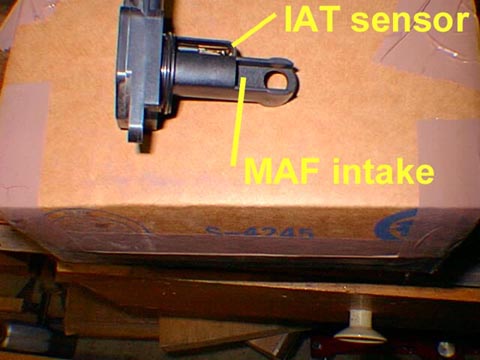

a) what year is your vehicle?
b) what code is actually being generated?
c) from what you describe, this happens routinely on
99+ models, and its likely a dirty MAF. Clean it.
CEL will go on and off by itself. If the ECU sees two consecutive out of spec errors, it lights the CEL. If it sees three consecutive OK trips, then it turns off the CEL.
https://www.yotatech.com/attachment....achmentid=1361
https://www.yotatech.com/attachment....achmentid=1362
