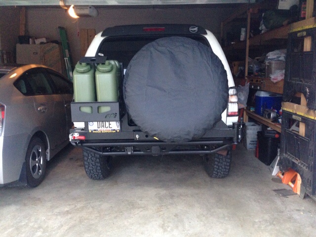

Great heavy duty bumper for sure. We only had a couple of problems with the bumper but I'm sure they will get worked out with Nathan. He has been very helpful through out the whole process.
I do have a question for others who installed one of these bumpers. Mine didn't come with a rear license plate light (required here). I can tell where the light goes, but not how the wires are supposed to be run.
How did you run your wiring?
Here are a few pics

I ran a wire and tapped the running light circuit from the trailer harness, and then just ran a seperate wire to ground out on a bare spot on the swingout. Wrapped it in a loom and zip tied it where needed. I also used a couple deans power pole connectors so i can quickly remove/install the swingout as needed.
