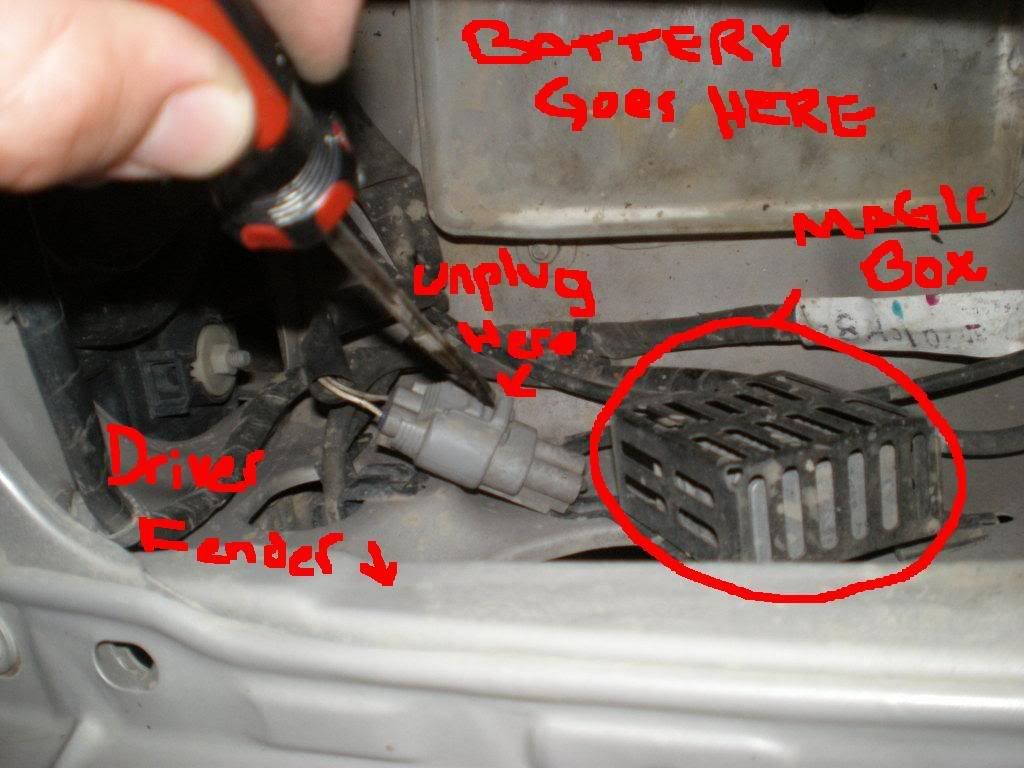

I found the wire. Piece of cake! It is a simple plug just like what was said.
The automatic On/Off still works great, so no possibility of "running the battery dead". I guess the 98-00 is a lot different than the 01-02 in that the auto off still works when disabling DRL's.
I dont know why they changed the design, because this was incredibly easy to disable, and I can enable down the road by just popping the hood and plugging it back in.
Thanks all for the help!

Just wanted to thank you for this advice, i read the forums on customtacos.com and toyotanation that tells u to cut the white wire with black stripe on the DRL relay to disable the DRLs but after cutting that wire it didnt help at all!!!, but once i found this lil black magic box and disabled it, it worked like a charm. Thanks so much for the CORRECT info.
Originally Posted by Rick F.
My 2000 SR5 has a connector between the battery and the fender that can be unplugged to defeat the DRL's. It has no impact on the remaining light functions nor my fog lights. I don't understand why you'd want to follow the TSB and cut wires when all you have to do is unplug 1 connector...

Maybe too late but this might help someone. This should break it down pretty well for you guys...(I was bored)

Thanks alot TRD_4runnin11, that should help out. I have already found that magical DRL box.
