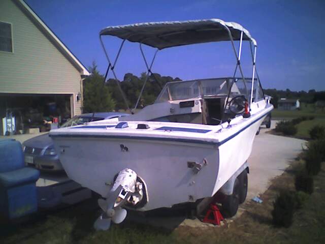

Here's mine, not as big as yours but it works
