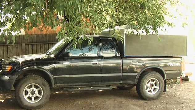

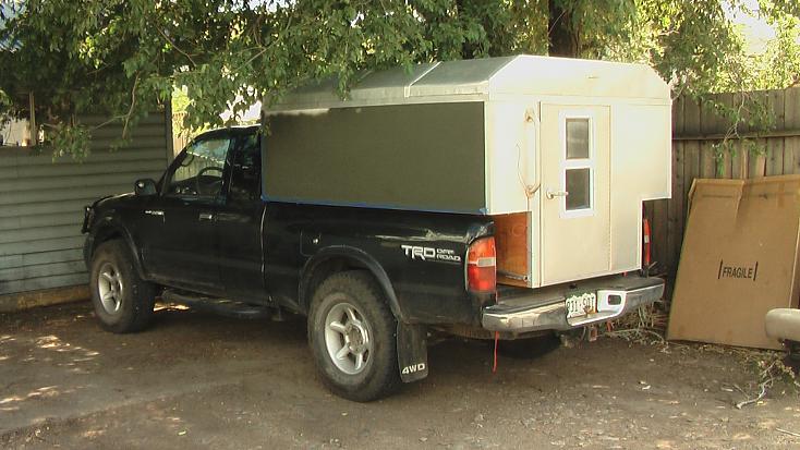

I just joined yotatech, so I'm just trying to get familiar with this. I built a popup camper this summer for my 99 tacoma, and It weighs an estimated 400-500 lbs. I have been wanting to get a small lift for my truck since I got it a year ago, but now that I have finished my camper I need to do suspension work so that it can carry the weight better. I have done research on AALs, but I don't know how much weight they help to carry. I've also read that they lessen your truck's flexing? are there any other lift systems that would help carry weight and at the same time lift my truck 1-2"? I also need to lift the front end of my truck 1-2", so what would be a good combination?

HOLY inverted springs batman!!
yes you need new springs. might want to look into 63" Chevys. they're known for giving 2-3" of lift, but with your added weight it should be perfect.
