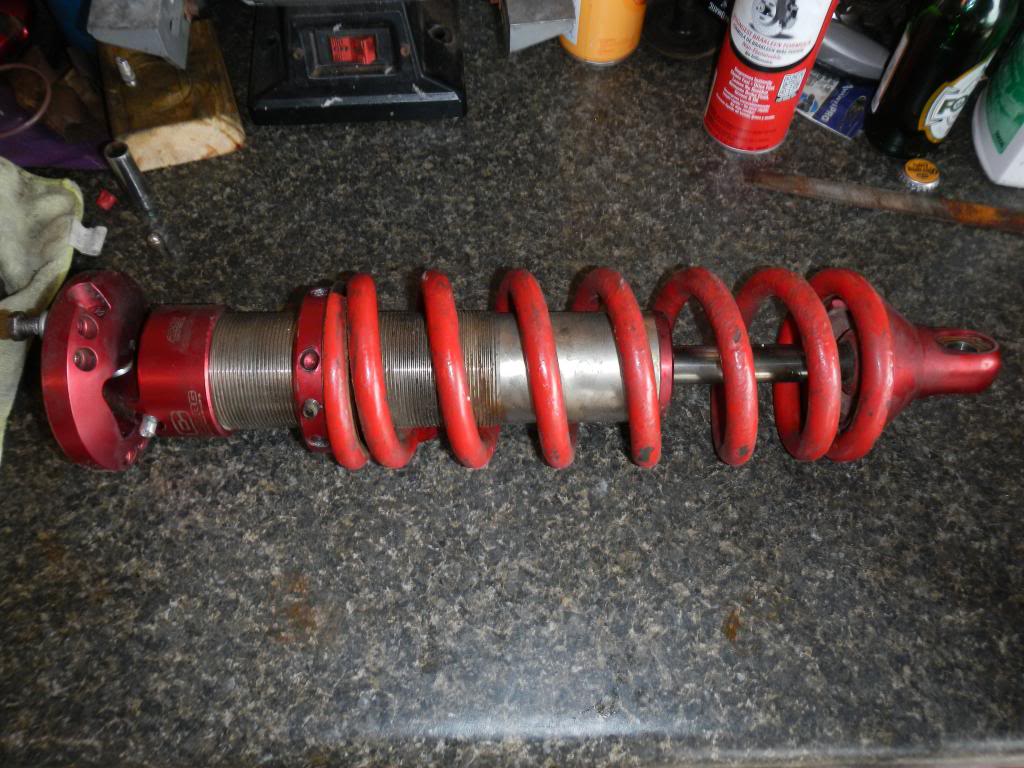

This is what i had to start

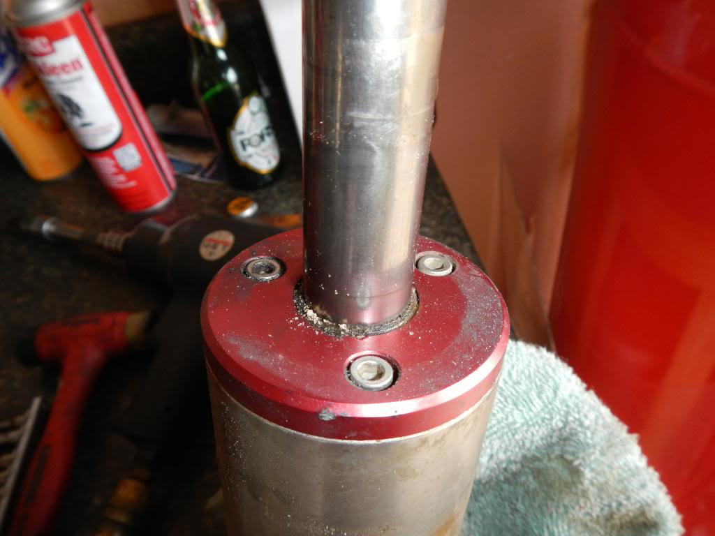

Pull those screws out.

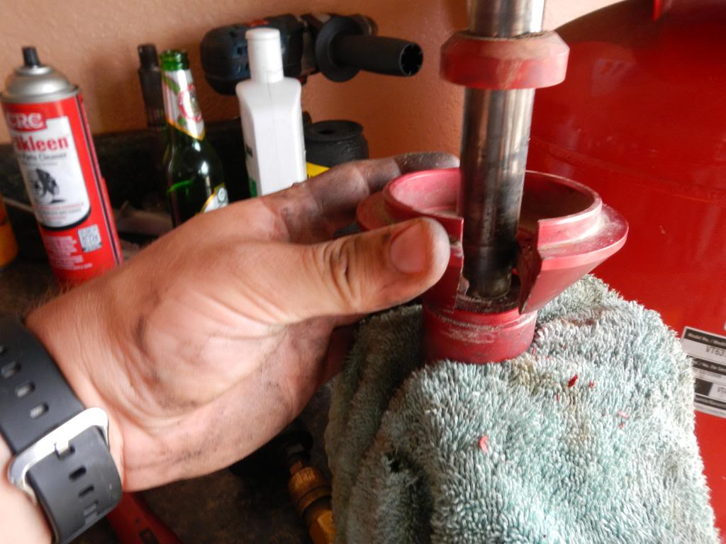

pull that clip out that hold the shaft asbly in, and slowly pull it out! it will make a mess so be ready for it.

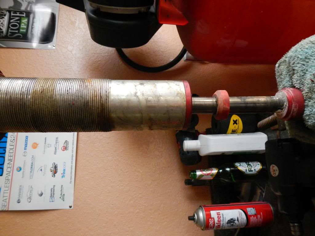

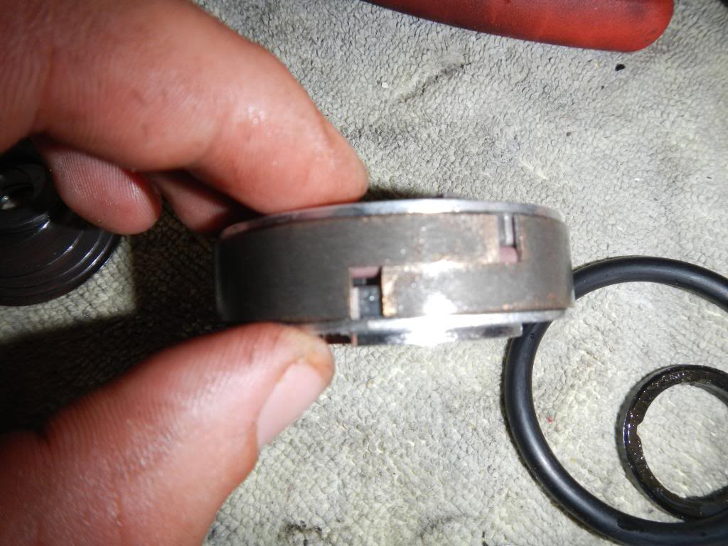

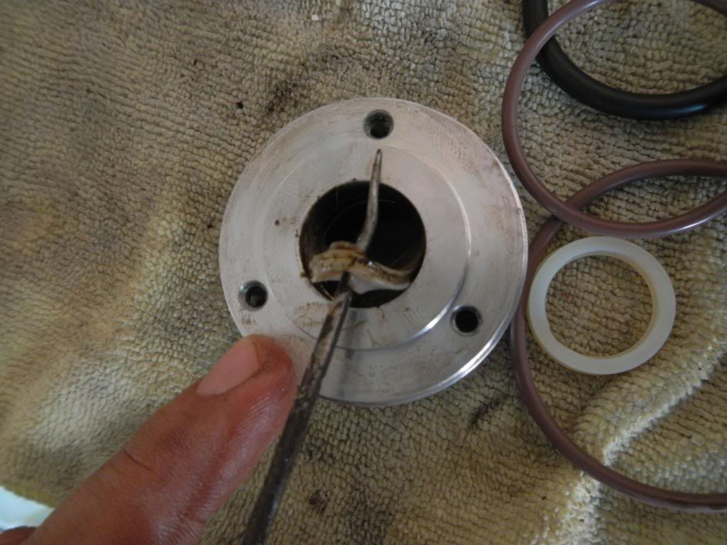

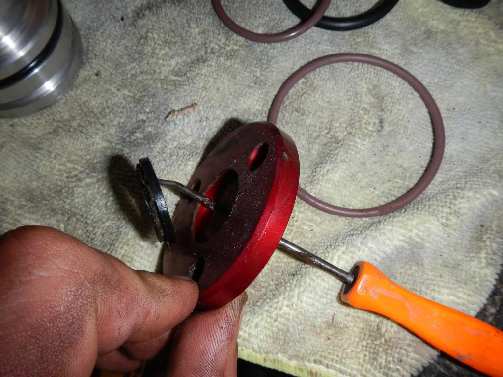

then this is what you have to put all new seals in. Make sure you pay attention how it come apart!!! the bolt that holds this all together is a one time use bolt so you need 2 new nuts for the rebuild!
now replace all the seals
that metal ring around the out side of that is the wear band

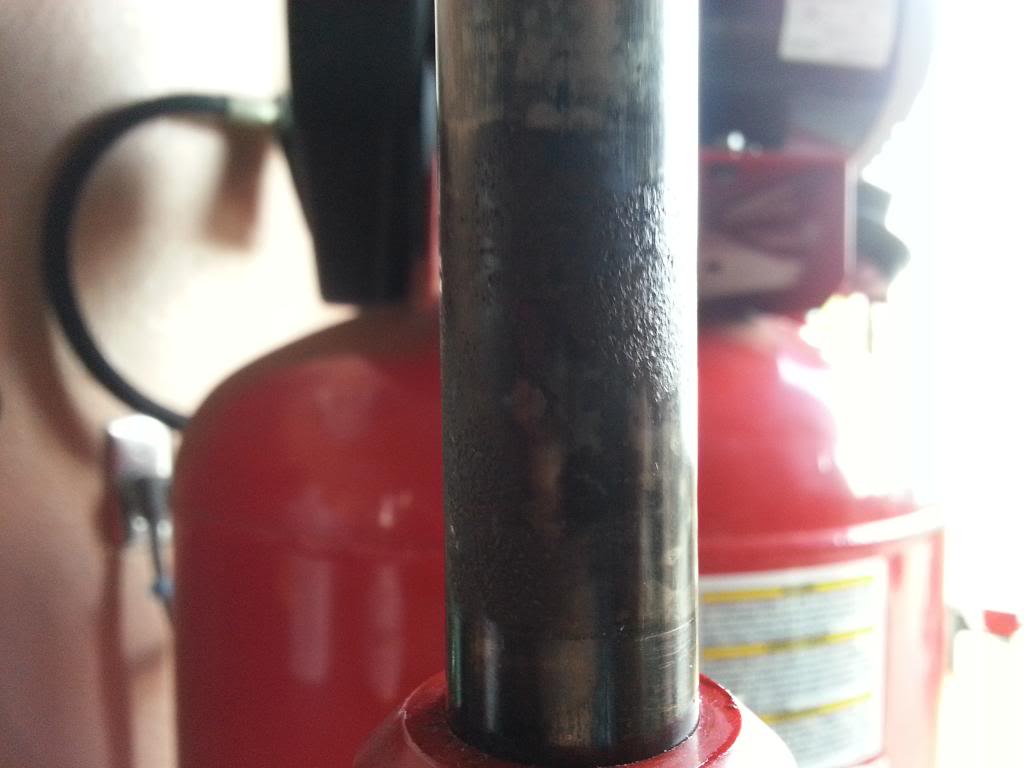

once I took this shock apart i realize that the shock shaft was really pitted bad so I had to order a new shaft for 54 dollars.

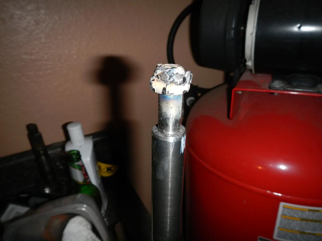

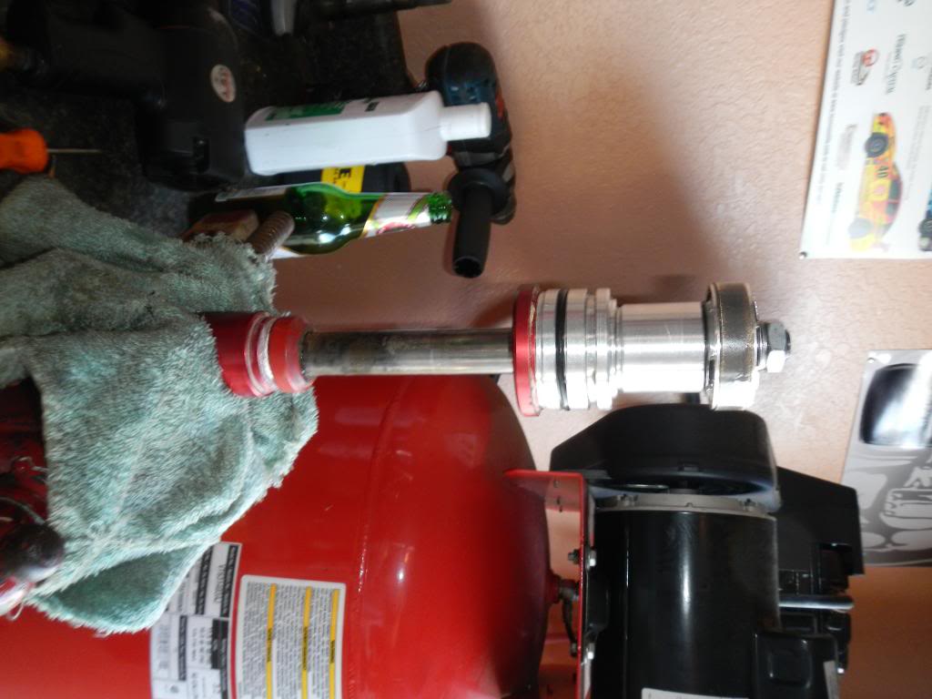

Now the fun part getting the shaft off the end of the shock! I decided just to weld the nut on and impact gun it!
but some lock-tight on the shaft, and put it back in.
so now you can put the stuff back on the shaft with your new nut, witch they told me to just tighten it tight cuz it is a lock nut and dose not really carry a load, it does not need a torque spec.

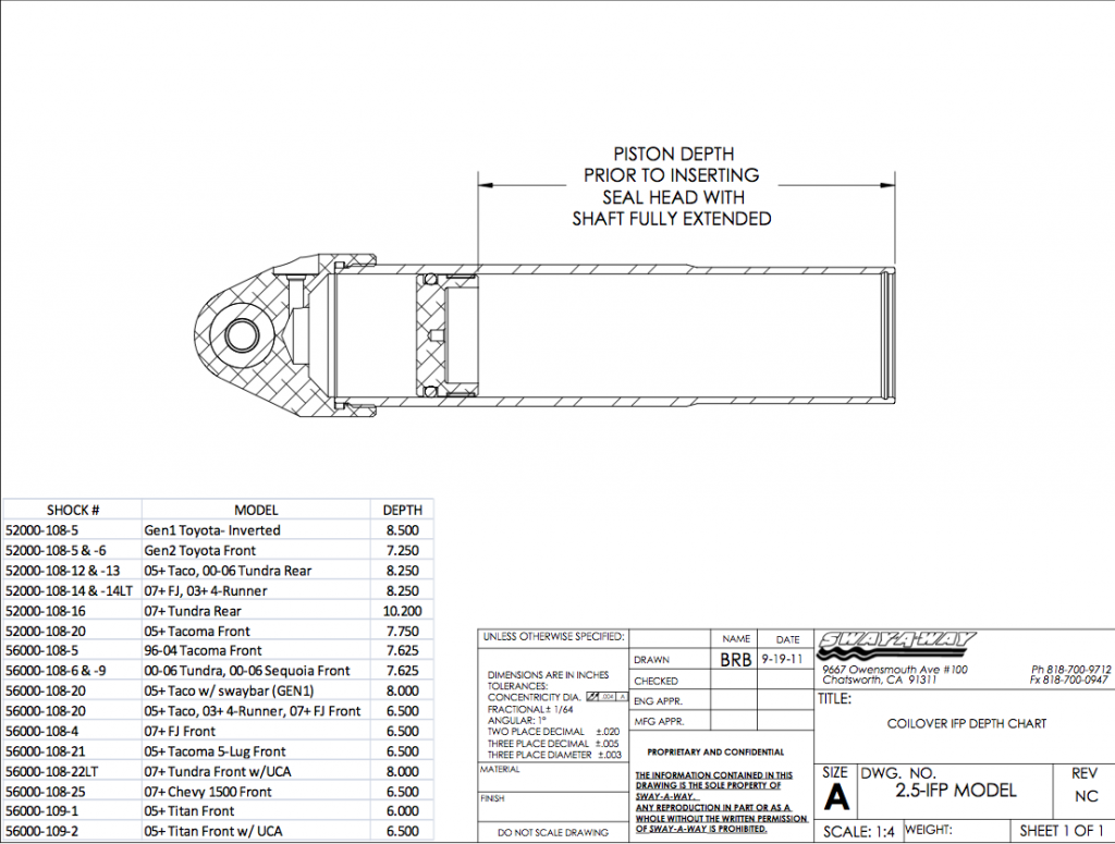

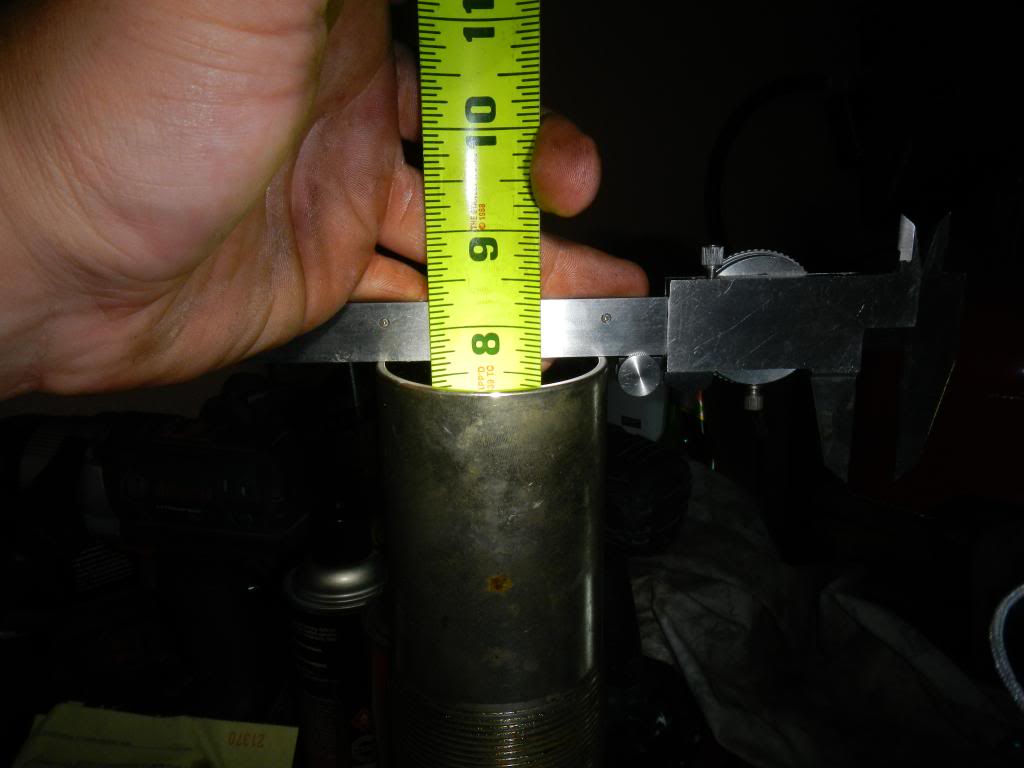

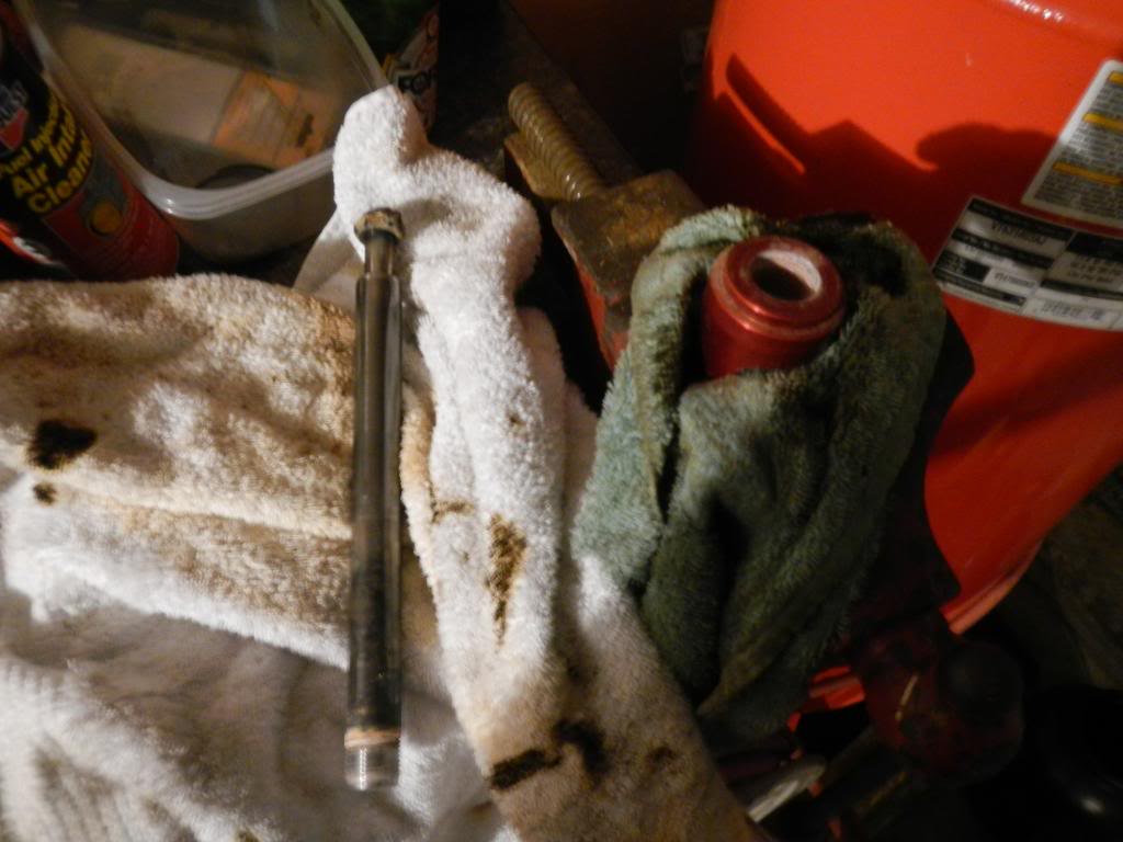

now there is a piston down the tube, so I took off the shreader valve and put air in there but BE CARFUL you are making a cannon so only put a small amount of air and blow it out. replace the seal and put it back in, make sure the inside if the shock is clean. When you put the piston back in you have to measure from the top of the piston to the end of the tube, on this one it is 7 5/8
Then you need to fill the shock tube about 3/4 full of oil and slowly put the shaft in there and right before that last piece goes in it should be squeezing the last bit of oil out.

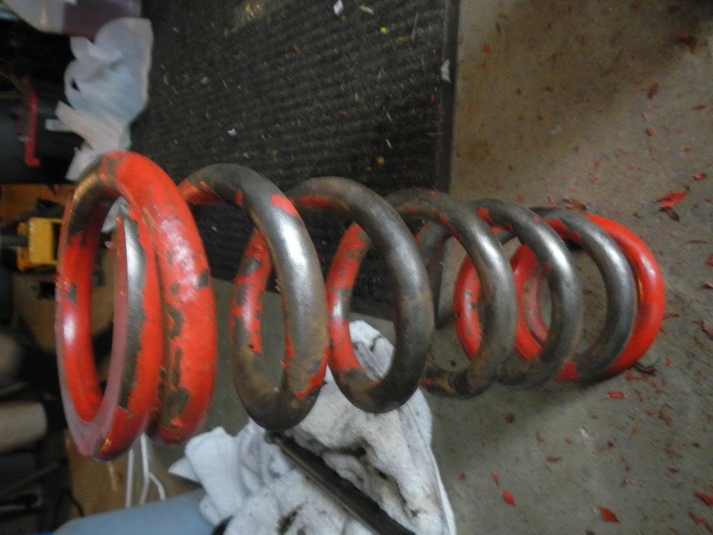

My coils were starting to flake the original coat of paint off so I sanded them down and painted them. they turned out pretty lame but I need them on so I just put it on any way.
To this!

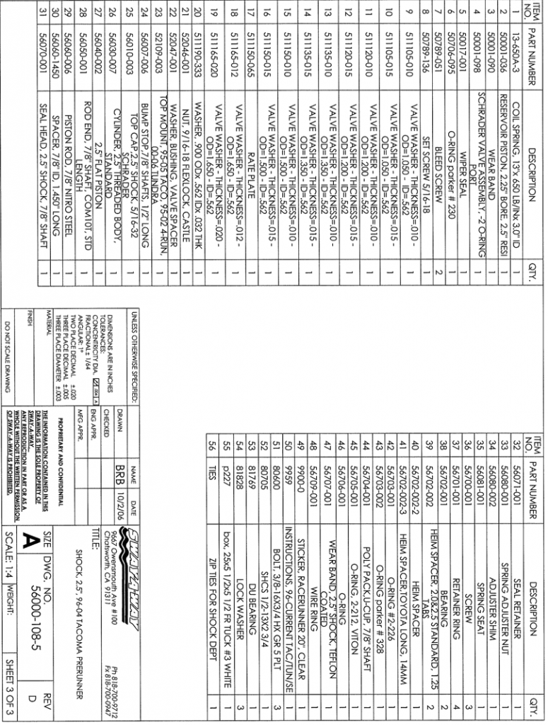

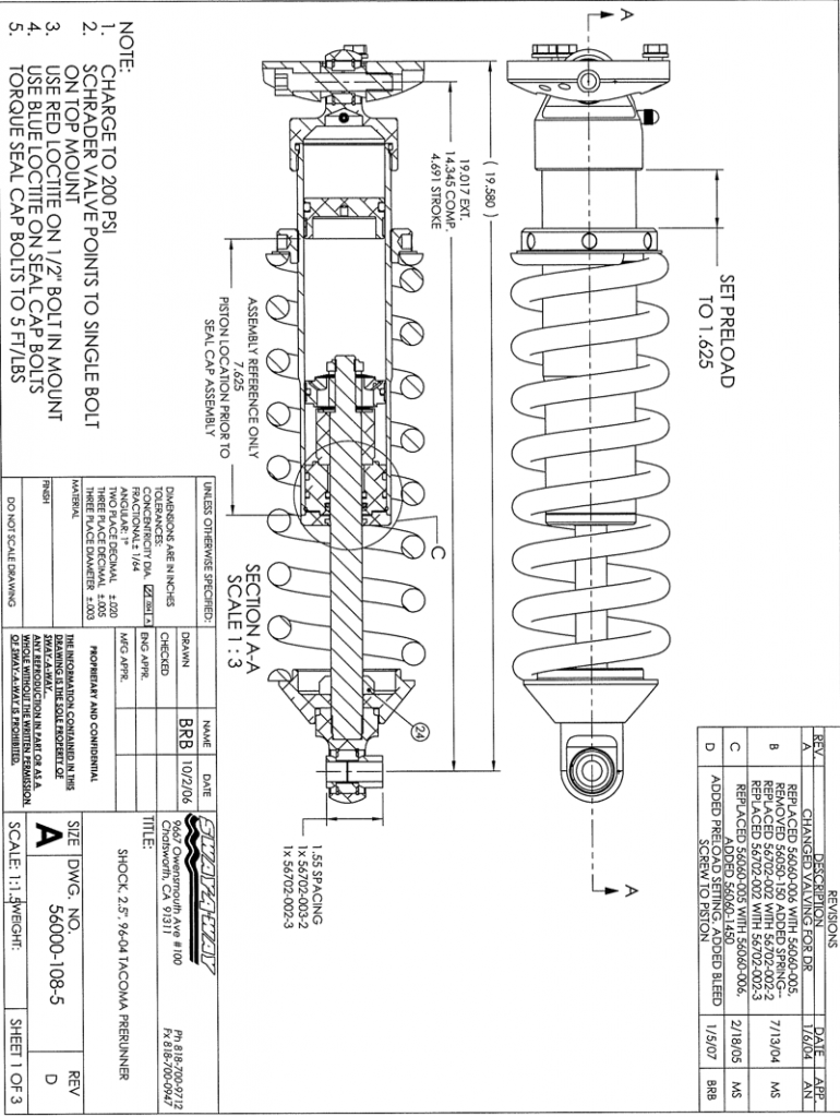

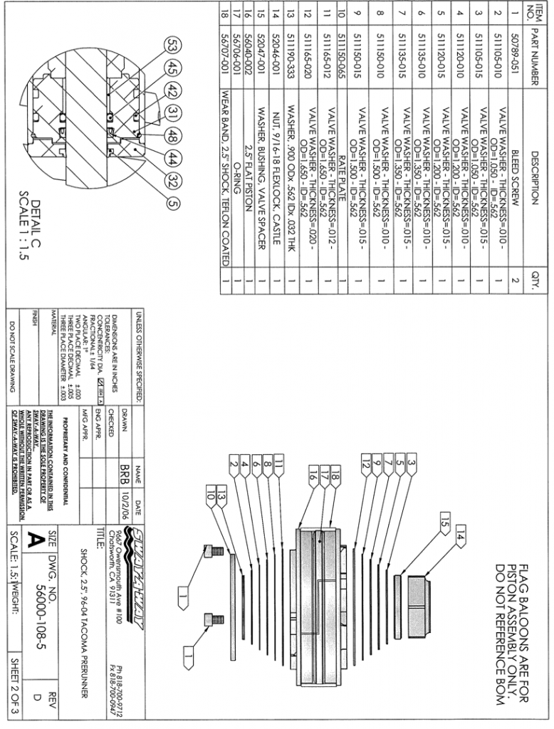

I also got some diagram from sway-a-way if this helps and so you know im not blowing smoke up you know were!
I hope this helps out!!!

Thanks for the write-up; saves me the trouble of writing one!
I am rebuilding my 2.0's at the moment and I thought that I would add that after calling SAW, the depth to set the piston (between oil and nitrogen) on the 2.0's is 7 1/4" instead of the 7 5/8" for the 2.5's
