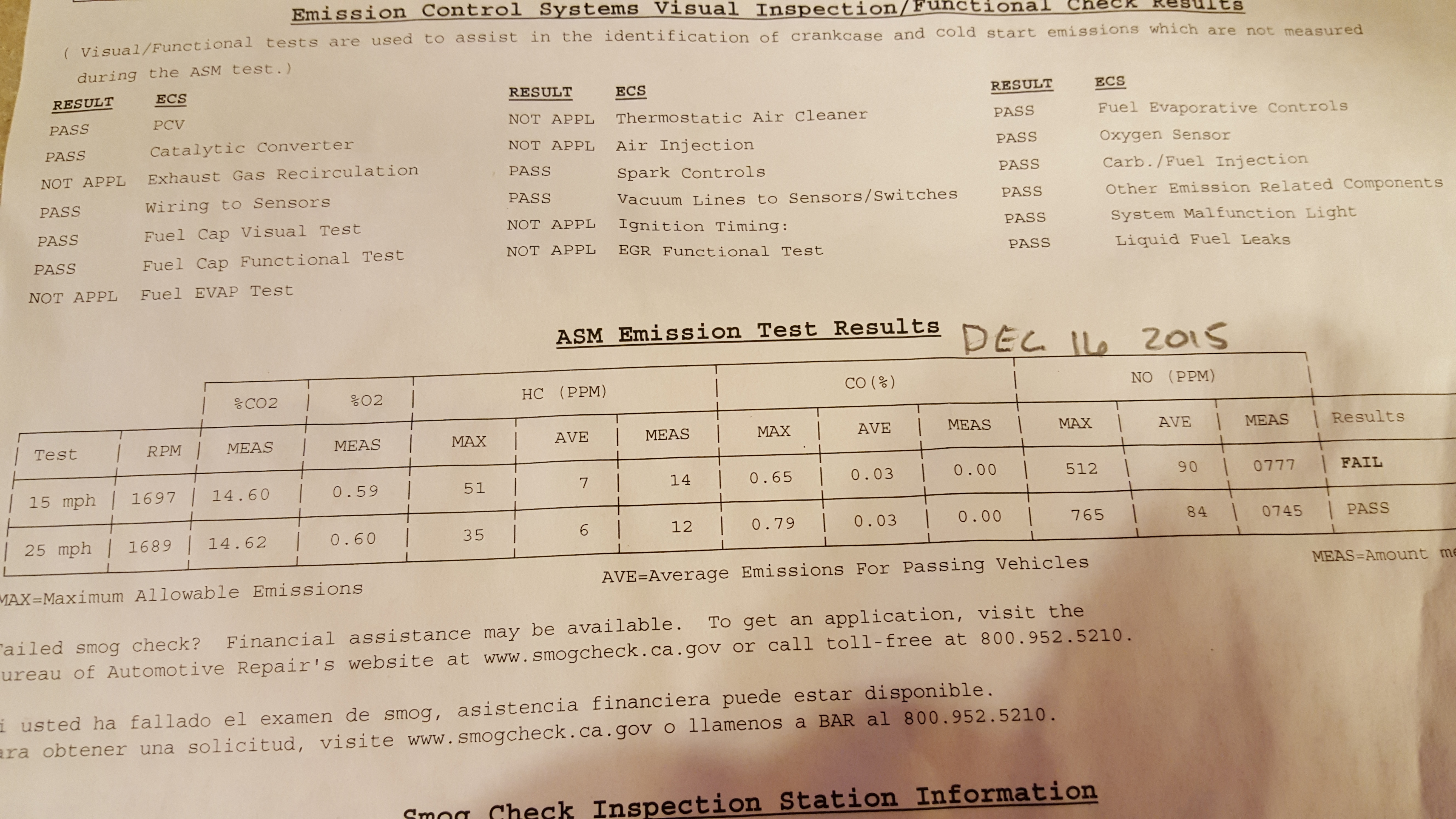

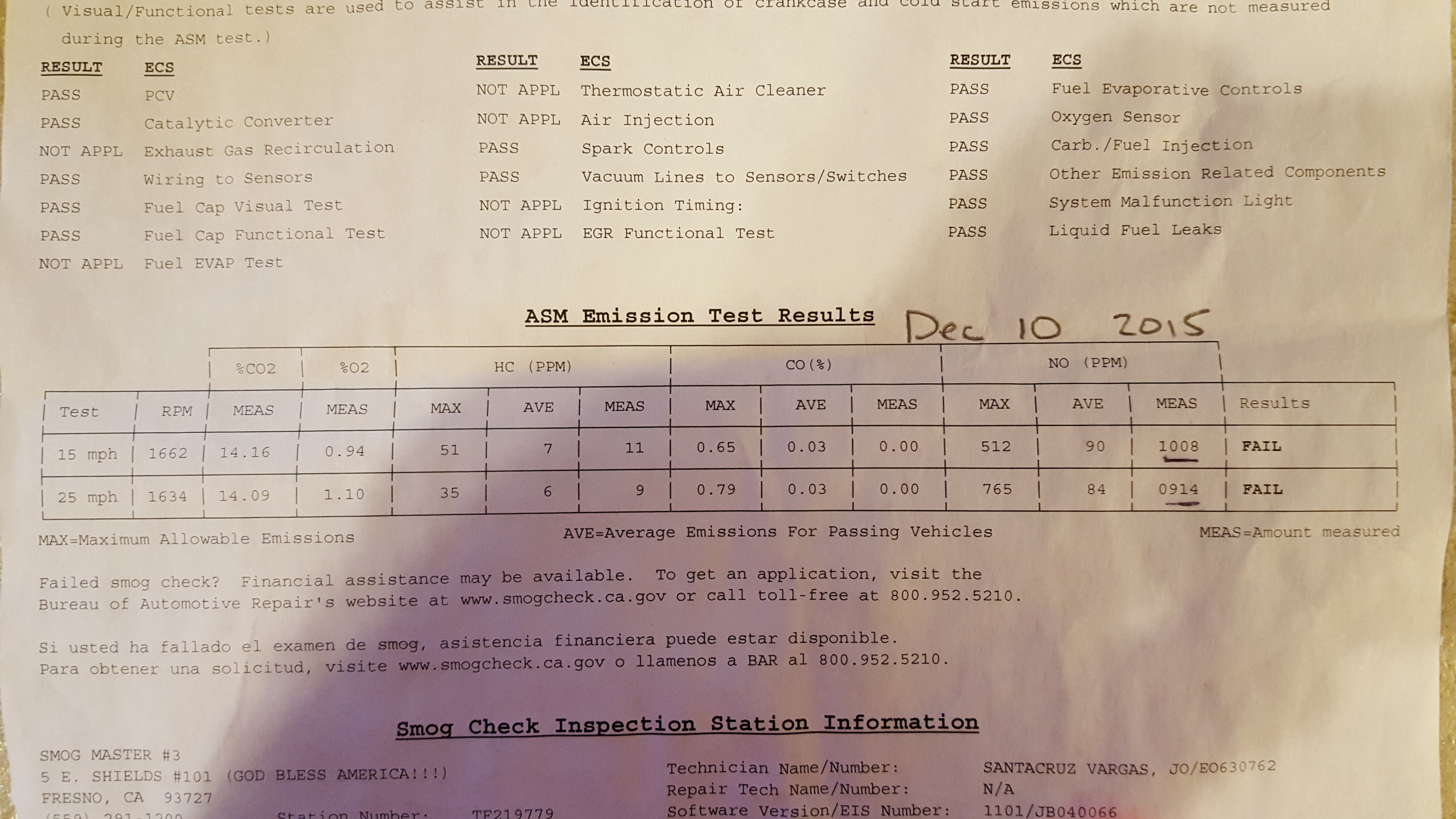

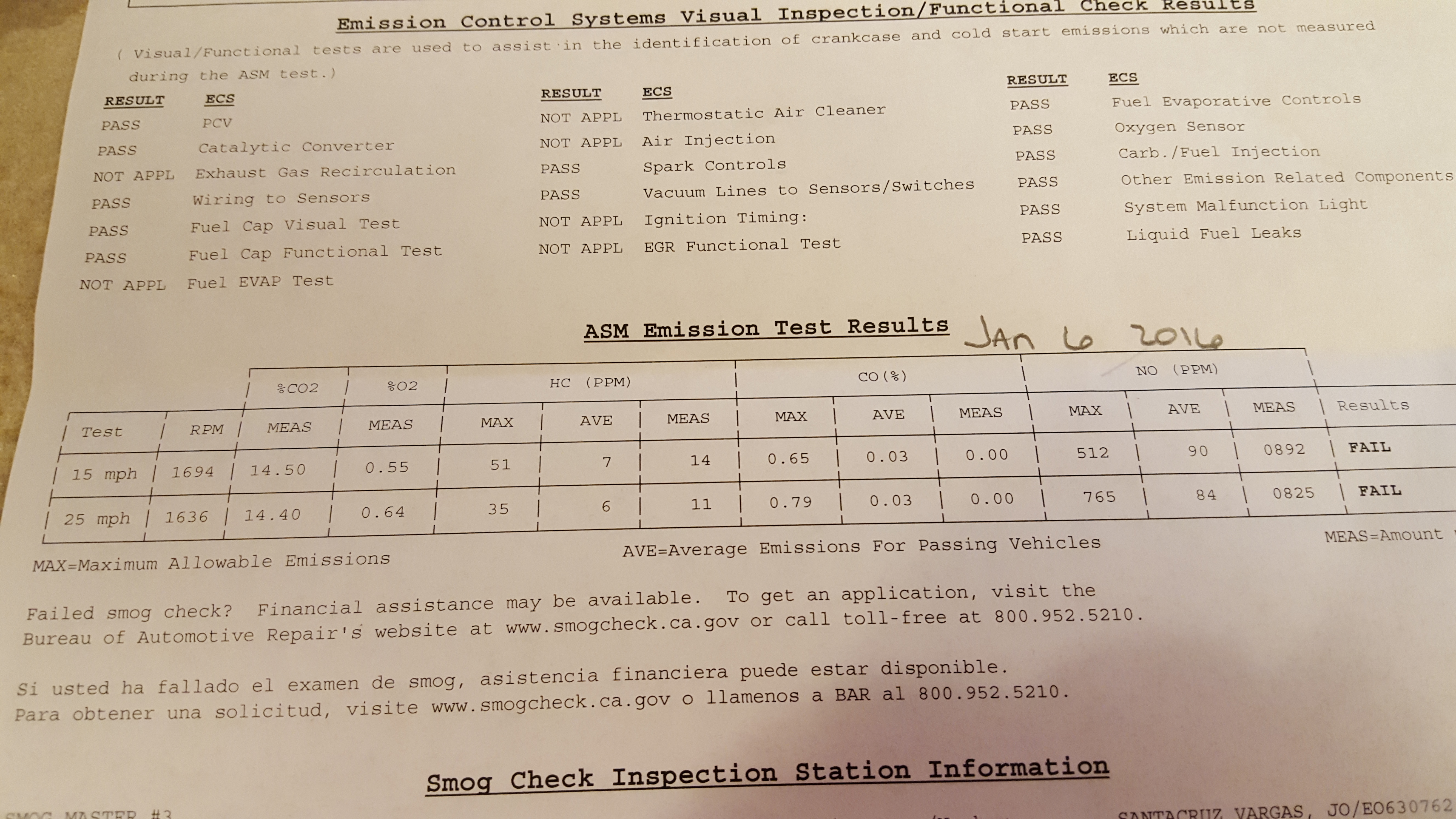

Been 3 times for tests and I am going backwards.
12-10-15
Just took it in. Drives great, no smoke, no codes. FAILED
12-16-15
Changed front o2, cleaned MAF, checked for any leaks in air intake boot. a few small cracks were sealed up with electrical tape.
1-6-16
Changed plugs, wires, fuel filter. Seafoam through PCV hose and then again about a week later. A little in the tank, ran through almost all that gas, and then refilled with super Chevron.
FAILED and got WORSE!!!! LOl
WTF
Any ideas? I know that the CAT is my next step but Id rather hear some thoughts before I drop $250 on it
Also, the guy at the test only place is telling me to change out the rear o2 and that would help. I have always understood that the rear o2 isn't doing much and therefore wouldn't help in this case. Any thoughts before I drop another 60 on a new o2 for the rear?

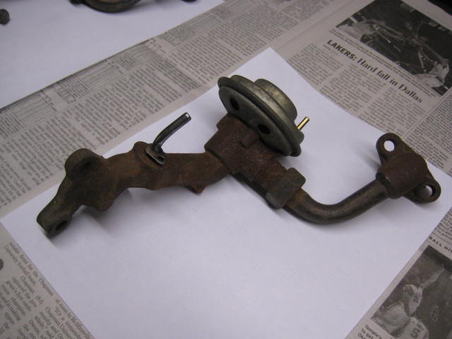

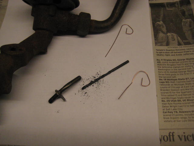

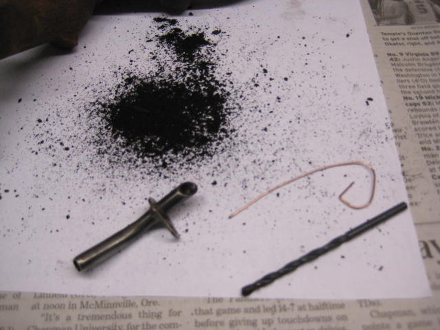

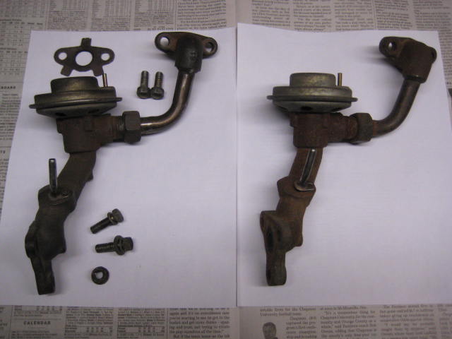

I had problems with my EGR system causing high NO. Vacuum hose routing was mixed up. Check the routing carefully as its easy to mix up. Also look at condition of vacuum hoses and make sure they hold vacuum pressure or they are not clogged.
Take off the EGR and inspect where the small hard line tube.... see photos.
Mine was completely plugged with carbon deposits. The deposits are hard and crusty so devise some way of mechanically scraping. A drill bit and some welding wire worked well for me.

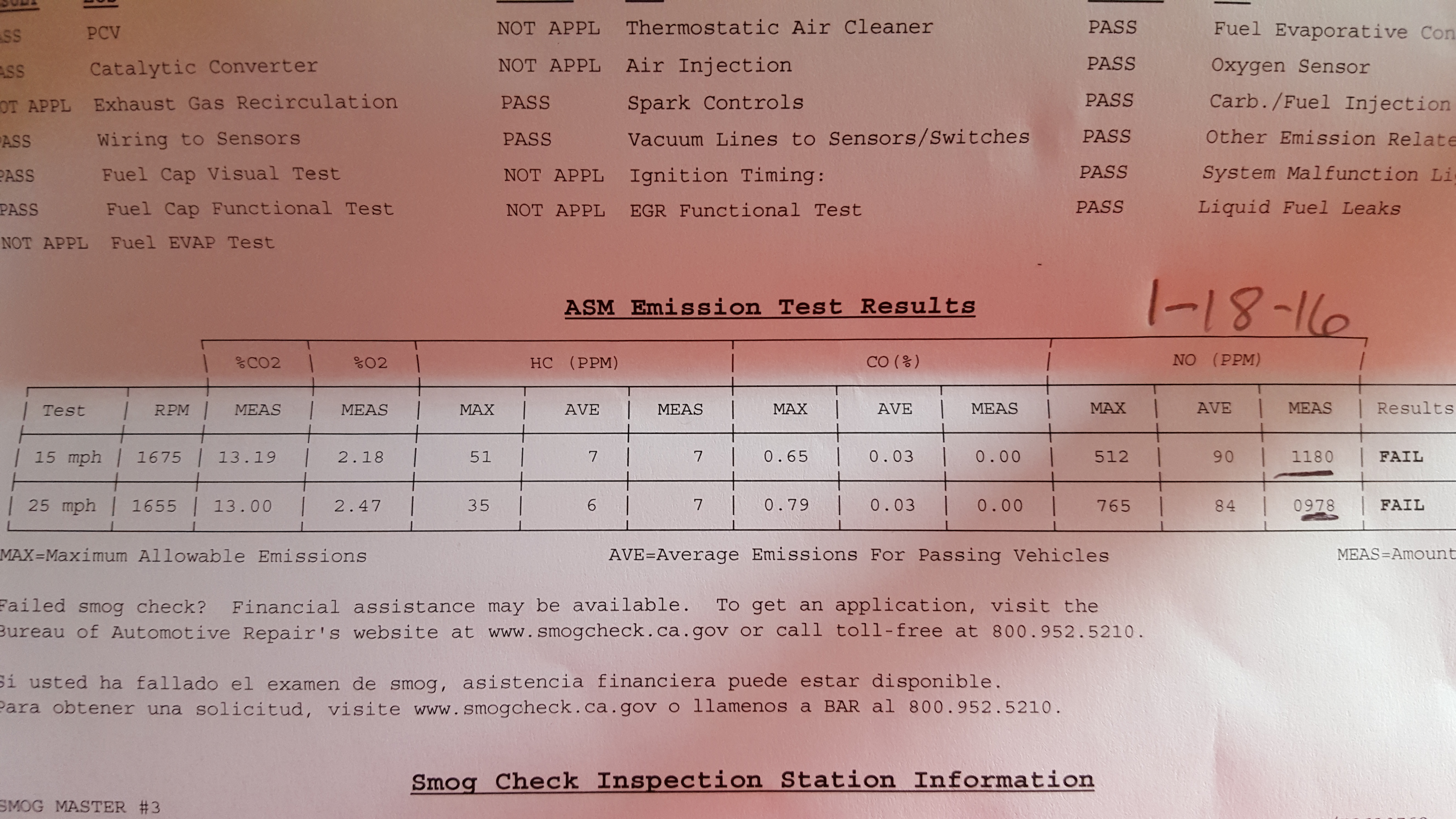

Frustrated!!!!
Changed the rear o2 sensor to another NEW Denso, replaced the CAT with an Easton brand new unit.
Took it back in today and again........its gotten worse. WTF
Didnt try to E85 as I figured the new CAT would solve it with the new rear o2 being a bit of overkill.
Other than a new MAF, I cannot think of where to go from here.
Smog guy did feel sorry for me and didn't charge me, so that was good. LOL

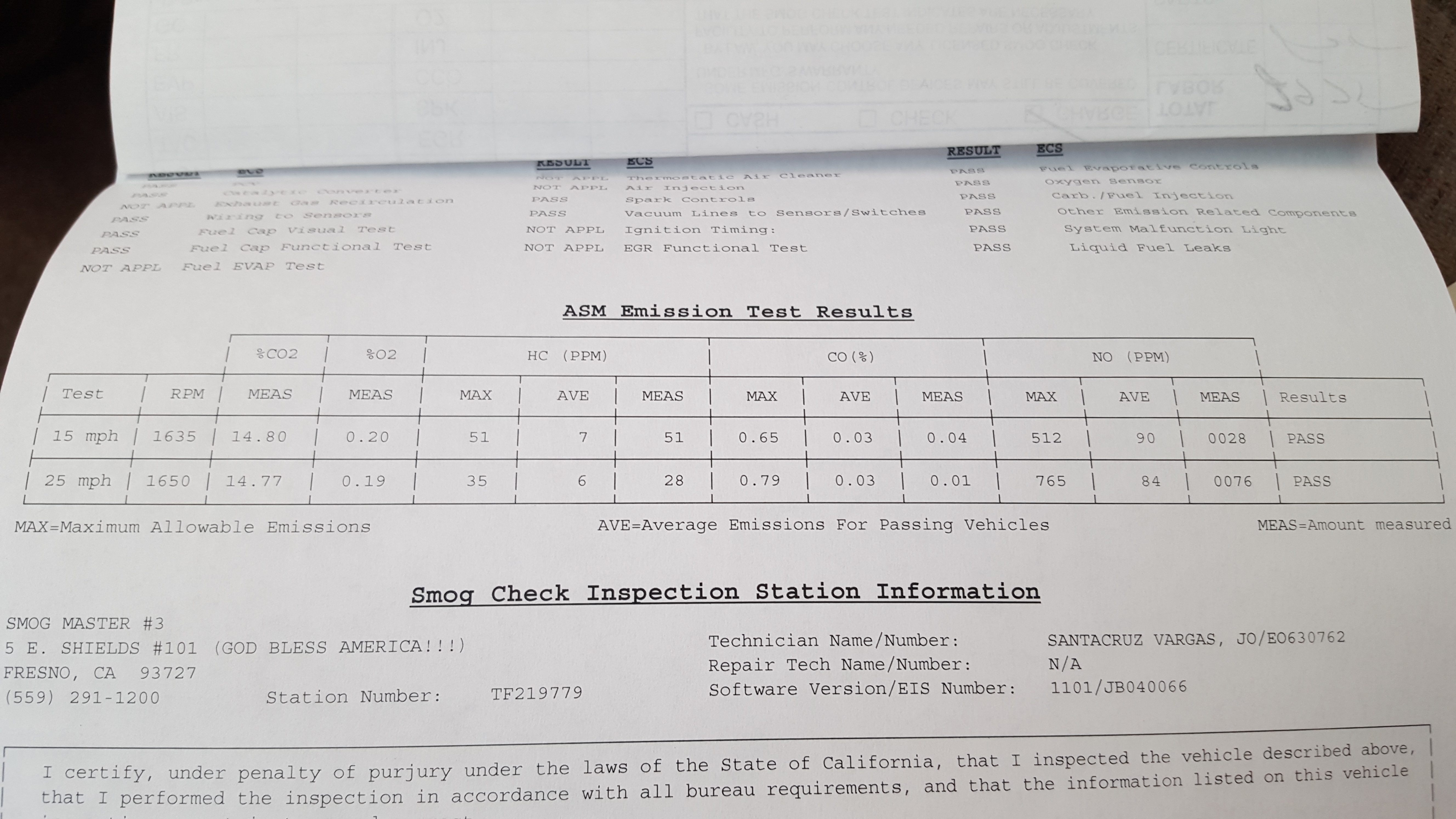

Thought I would update this for future searchers for similar problems
After changing out the wires, plugs, fuel filter, CAT, both O2 sensors, seafoaming this intake.....twice. It turns out the culprit the whole time could have been the timing. Who knows if any of the other items I changed contributed to it passing along with the timing belt but I dont care cause it passed today.
So if you have this high NO problem, check your timing.
Old 02-06-2016, 11:13 AM
tantacoma's Avatar
Join Date: Mar 2012
Location: Folsom, CA
Posts: 197
Received 1 Like on 1 Post
Looks like it BARELY passed. You were at the max for HC !!
