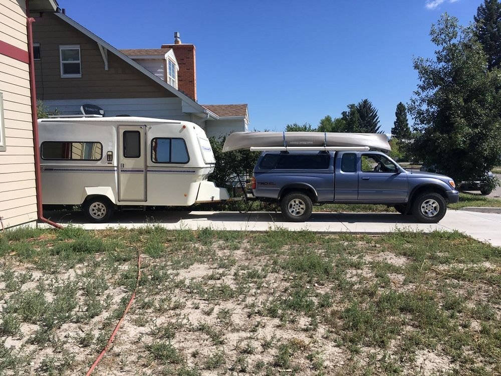

These trucks have notoriously soft suspension. They were built for offroading, not for work. They'll work as work trucks because they're built well and built to last, but it wasn't the intended use, so it takes some modifications. I pull a 17' camper trailer with my 98, probably 300-350 pounds tongue weight plus my topper and a lot of gear in the back of my truck. I have both aftermarket HD leaf springs (I replaced the entire leaf pack) and air bags in the back. That keeps my truck level. But it doesn't do anything to increase the payload. Keep that in mind.
