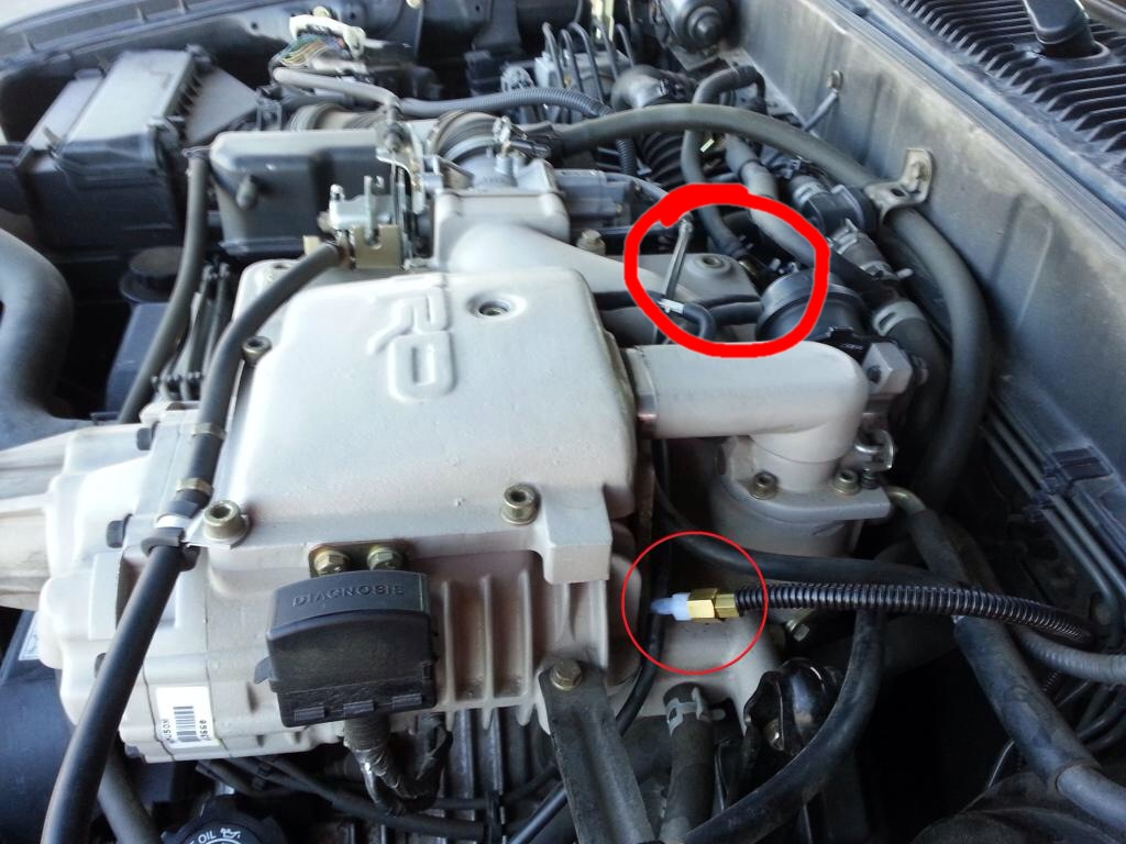

I have a 99 4Runner with the TRD Supercharger, I just had a shop install an Autometer boost gauge. When I picked it up they said that they were only getting 2-3 psi of boost and that I may just need to service the supercharger. Well when I drove it home I was only getting vacuum, no boost. At idle I was showing around 17 psi vacuum, just cruising I would get about 10 psi and when I really got on the gas it would only hit "0". I am guessing they hooked it up wrong, can somebody tell from the picture below if they hooked into the wrong line?
Thanks!

as long as the hose is hooked into the intake manifold in a spot that is unaffected by the throttle position it should be fine. You could try changing the vac tube location to another point and see if that changes your numbers.
Engine vacuum is counted in inches of mercury, not psi. Boost is calculated in psi. Pulling 17 inches at idle sounds about right as does 10 inches while cruising.
Hopefully someone with the same setup can chime in. Changing the thread title (if possible) to something with "3.4 supercharger" in it will bring in the people you need.

reading vacuum is small negative pressure. But if its got a poor connection under boost it could be leaking. However these first gen sc units were prone to leaks around the idle bypass valve.

where does the line run to? it doesn't show in the picture and I have a black second gen sc.

Looked at the video, the source is okay. What else is pigtailed into that line? do you have any fuel mods on the rig?

i have the black s/c and it has an allen head set screw type of deal on the back on the s/c.. remove that and install brass fitting that came with the boost gauge. feel around for a spot on the back.. its looks wrong with all thoes T's.
some info here http://www.gadgetonline.com/Super.htm

Just my $0.02, but it looks as if they might have just tapped into a vacuum line.
I just ran it past our MDT here at work. He thinks they tapped into a vacuum line to, especially if vacuums all your reading. I've seen guys tap into this port here to read boost before.

Hmmmm, I talked to the shop and they insisted it was done correctly, they were actually kind of jerks about it.... I see you are in Colorado, know of any good shops that can take a look at it?
