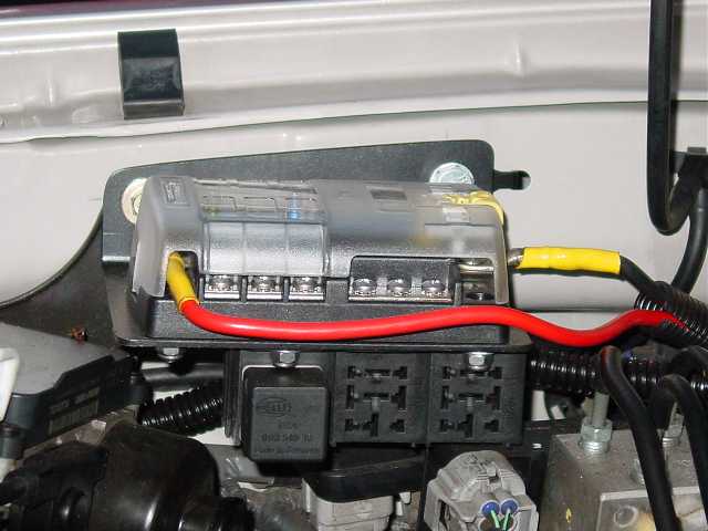

A promised..............

That is sweet! I dig it
